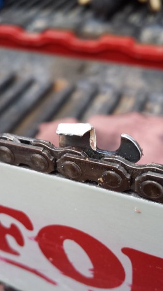

    Was cleaning saws and filing chains before putting everything up and came across this one. It's one single tooth on the entire 24" Oregon LGX chain. The entire corner is gone.
    I'm still in the learning stages of grinding chains but so far so good. What's the best course of action for this one? Grind it back and do them all the same or can I avoid that some how?

    One cutter just grind or file it back and set that raker. No need to kill a lot of chain life for one cutter. If it was half the cutters on that side then I would do something to the whole chain.

    Thats what I do too. I'm with Mike on this.

    I would just grind it to the same length as the others and call it good. It'll clean up after a few sharpenings.

    That one tooth won't hurt anything if it's a little shorter. Mike said it best. Get that one in good shape and just do the rest of the chain as you normally would.

    No, but next go around on sharpening, then it means either it won't get sharpened (ie... what I suggested for this go around), or having to remove a bunch of metal from the other teeth so it does,... or I guess sharpening it short until the chain is used up.
