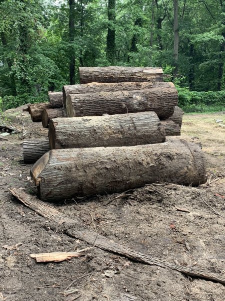

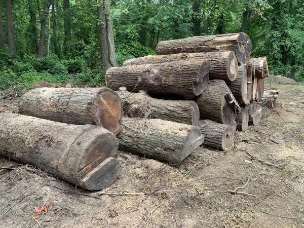

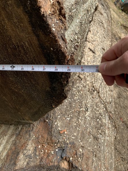

    I have a feeling that some of the other South Jersey hoarders may recognize this pile of oak???? Just went to check it out today and there is decent trailer/truck access. I have never worked a pile like this and have no heavy equip. Any suggestions on where to start would be greatly appreciated. I may be in a little over my head here and want to keep safety my top priority. Will be a bit before I’m ready to take this wood in so I have some time to prep. (Yes the wood may disappear ). So far I’m thinking tow strap that first log away from pile and then buck away without danger of logs rolling down on me. Think I could roll that beast with a 60in cant hook? That log is 29” diameter and about 6’-7’ long. Anyone up to tag team some of this ? I can prob only take 1.5 logs in a trip at best due to trailer capacity limitations. I estimate some of these logs weigh over 1500 lbs each. I think it’s safe to assume that if I attempt this I will also need to quickly acquire a big boy saw. My ms250 ain’t gonna cut it here.

    60" cant hook will roll those on that ground. 70CC & 24" bar with semi chisel chain, roll one out, cut it, split or noodle to a manageable size load, rinse & repeat. Those are perfect size logs in my world. Quarter the rounds & they're pretty manageable. I'd be tempted to climb that pile & buck up there, no dirt. Just be mindful of the bar tip for kickback. FWIW, those logs are a ways north of 1500lbs. when they're Oak. That's a great score. Working alone that's a couple good days of work without hydraulics. Be well worth the effort though.
    Edit: Grab a wedge or two to follow your bar through the cut to prevent a pinch, that can cause some headaches.

    I wouldn't screw with a splitter at the sight, by hydraulics I meant a loader & dump trailer. Those things are misery to get under the wedge whole. I'd be real tempted to climb the pile & cut & tip the rounds off the side or roll em down the pile. Once they're down, noodle cut 3/4 of the way through, roll 90 degrees & repeat. Stand the round up with your cant hook & hit it with a maul, they'll break right apart. Then you have a piece you can handle & get into the splitter at home. If you're not comfortable cutting on the pile, roll that first one out & watch what the next one does very carefully. That pile looks pretty stable, but be careful, those logs are enough to flatten you.

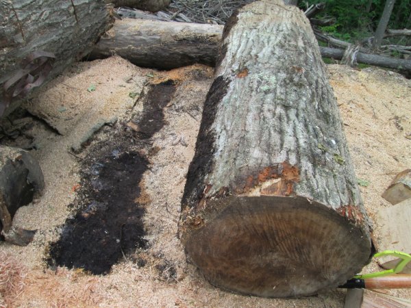

    I rolled this 32" oak round with my peavey last week. About the same length as yours.
    I was able to quarter/sixth the rounds with maul and Fiskars X27 axe. Some i did have to noodle due to knots/twisty grain. As amateur cutter stated those are heavy logs and be very mindful of how the upper ones will move if you buck the lower first (which is what i would do) Bring a stiff bristled brush to remove grit where you will cut. Bring file and/or extra chain as it will dull fast as ive learned.

    Gravity. Never stand below where it wants to roll. It's a simple rule that will save you. Good score btw.

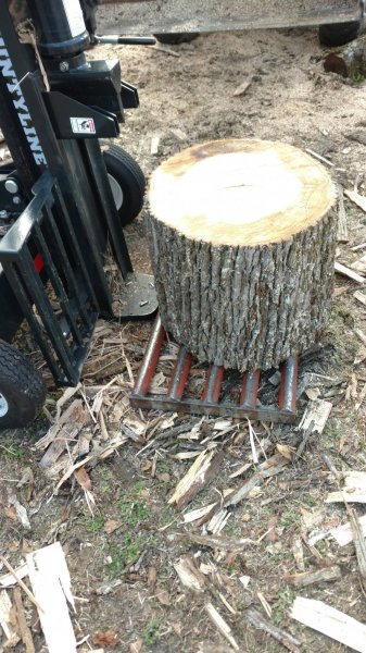

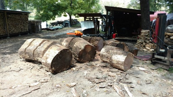

    Yes roll the first log away from pile with cant hook and buck to length. If you have ramps, you could roll on to trailer, or half/quarter if you want to tote it. Second log should drop straight down roll it out, might can get third log to move, just keep hook on the end of the log and stand to the side. If you have a 16" bar you can cut those logs, takes a bit longer. I've cut 28" red oak with a 1800 Poulan from Walmart years ago... As for going vertical, you probably saw the metal rack we built for our splitter. It is just heavy duty angle iron and 1 1/2" pipe welded together. Rounds slide pretty good on it. IMG_20190115_140952755.jpg
    This is another way to tackle the problem, we built another one with 2 pieces of 2x8 boards with 3 pieces of decking boards screwed cross wise under the bottom. Doesn't slide as good, but works. IMG_20180911_102423905.jpg IMG_20180920_201629817.jpg We roll the rounds up to the platform and tip them over on to the splitter. IMG_20180911_132306292.jpg

    Tow strap and a set of log tongs you can pull that pile apart a bit from the safety of the drivers seat. Just an option to consider to keep you out of the line of fire.
