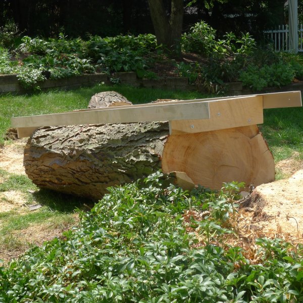

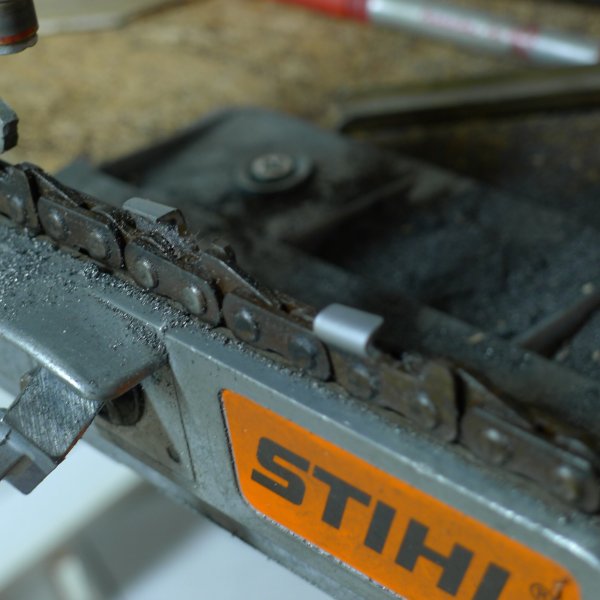

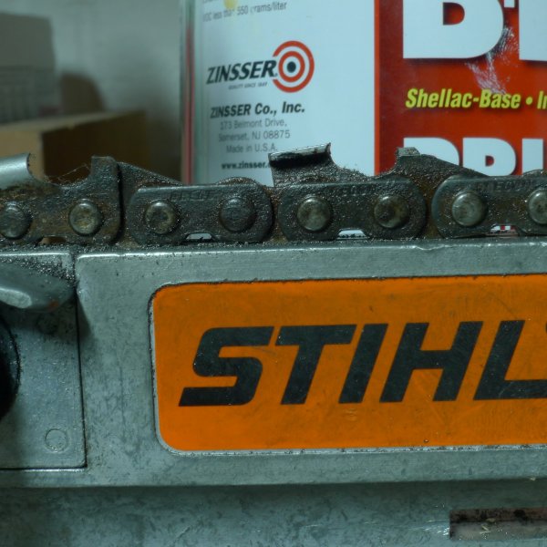

    Late this week I expect to try cutting some slabs for the first time with a secondhand Granberg mill. As luck would have it, the available tree is a 24"+ honeylocust. I'm guessing that would be a bit much for my 044, and the only bigger saw I have at the moment is a Homelite Super 1050, for which I have only the .404 chipper that came with it. I'd really rather not buy a new ripping chain for this venture, so I set up the FG2 and filed the top plate angles to 5 degrees and set the rakers to roughly 0.035. Any thoughts from the experienced millers here on how well this might work?

    That should work fine.5 to 10 degrees is the usual,I've even heard some set at 0 for frozen or abrasive stuff.

    I think that will work well for that application. I like having the rakers a little lower than normal. You want the chain to cut aggressively, not just sitting there spinning - it will run cooler and stay sharp longer that way. Locust is some hard stuff, and the windfall black locust that I get is especially hard on chains. So going with the semi chisel as you have is probably a good choice.

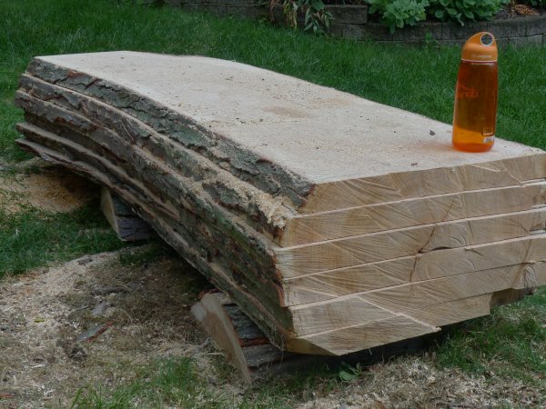

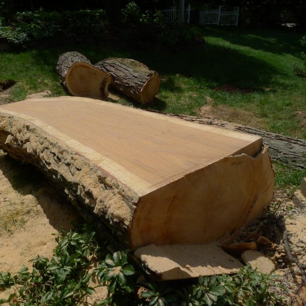

    Yep, it works!
  10. Jon1270
    Jon1270
    1,886
    4,543
    Pittsburgh, PA
    Incidentally, those slabs are about 25 board-feet apiece.
