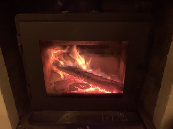

    Hello all. On my 2nd month with the Nova woodstove. I've got it mounted on the 4 small legs that came with the box. I'm using it as primary heat source for a 1,000 sq ft home in rural Kentucky. Most of my fires have been dry red oak.
    Short story: if I had to do it over again I would buy something else.
    Long story: I like the look of the Nova and the catalytic converter works very well. Unfortunately there are two, maybe three, criticisms that I've got and didn't see addressed anywhere online before I bought it. 1)Air. Starting a fire requires leaving the door open about 1" to allow enough air in. My kindling is dry paper and dry bark. I really wish Nova had one or two air intake valves to adjust instead of just leaving the door open. After 5 minutes I close the door.
    2)Firebox size. To look at it one assumes the firebox is an open cube. It's really a rectangle (on the bottom) with a triangle (on top). The "ceiling" inside the box is very tapered and really cuts into how much total wood you can fit into a full burn.
    3)Manual. The user manual states "The Nova has one setting: perfect." This kind of hogwash arrogance is unhelpful to say the least. The manual should contain information, not just some gimmicky sales jargon. It makes me really question who designed the Nova. Was it someone who has experience with heating a home with a woodstove? Or was it a few designers and marketing wunderkinds who just want to make buck?
    All said and done I will make this woodstove work to suit our needs. It gets hot and burns wood efficiently. We don't have kids and I DEFINITELY WOULD NOT BUY it if I had kids in the home... as leaving an open door on a woodstove is far from ideal. In my experience the Nova is more of an accessory-type woodstove and not a workhorse-type.
    Your miles may vary. Thanks for reading. :)

    I'm surprised there is no air intake control. That's crazy. You really need one to get the most out of your stove depending on a myriad of factors. What you CAN control is how you face the wood in there. Facing the splits east/west will restrict the air somewhat, giving you longer burn times. North/south will do the opposite. As far as starting it and having to leave the door open... Cracked 1/4" should be sufficient to get the air in there until the fire is established. As long as the bypass damper is open, the smoke shouldn't roll back into the room. Priming the flue first with a lit piece of paper or propane torch is good practice as well. I don't do it on really cold days, but when it's 30-40 out I usually do in order to get a draft going. I can't blame you for being less than thrilled with what you got.

    Front to back the box floor is 12", side to side it's 18". Just fyi.

    That's not all that different from my Lopi. If I really wanted to I could cram in a 20 1/2" split east/west but rarely do and never during a reload. I have quite a bit of "shorties" on hand for burning north/south. 12" fits about perfect in my firebox in that orientation.
