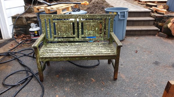

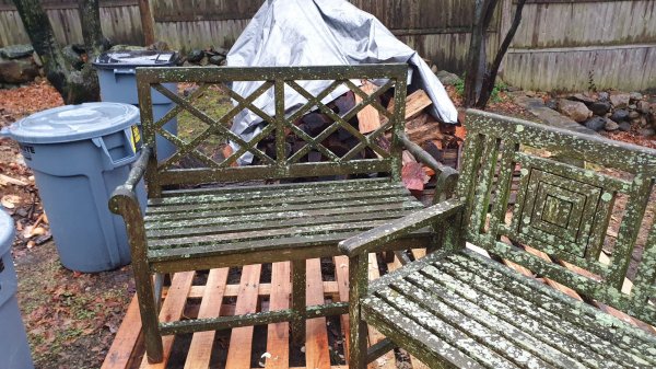

    As I have been keeping my eyes and ears open for scrounge wood, I noticed a neighbor who just moved in threw out two benches that were covered in lichen.
    I powerwashed gently with my cheap Home Depot electric power washer and look at the difference.
    Since I was busy with c/s/s 30 cords of wood,. I just washed the two benches and let them "air out" for a few months.

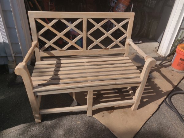

    Finally got around to sanding them and washing them down with teak cleaner (oxalic acid). That really brightened up the wood and the difference is stunning.

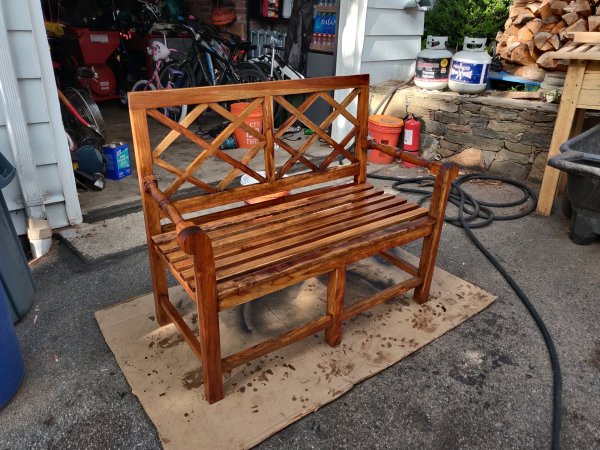

    Then I applied 3 coats of teak oil (watco from HD) with a foam brush and needless to say this bench will be used for many years to come.

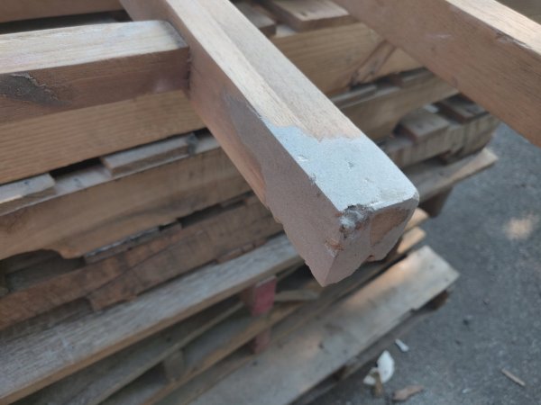

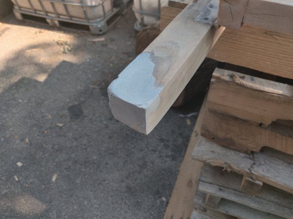

    I ended up just building up the missing wood with short strand fiberglass bondo and exterior screws. This method has worked really well on garage door jambs as well as my front door jamb that got ruined from the storm door ripping out of the jamb.
    I didn't really care about looks so much as I wanted the rot to stop and not get any worse. Very happy with the results.
    How I found them.......

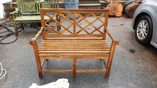

    Half pressure washed.........
    All clean...........

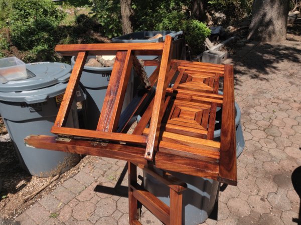

    Second bench that is collapsible.....

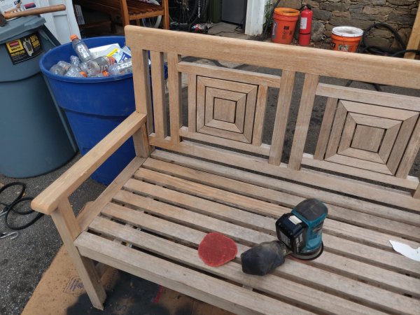

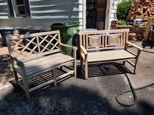

    Both benches were cleaned with oxalic acid but the right one was sanded.........
    All that weathered greyness was gone........

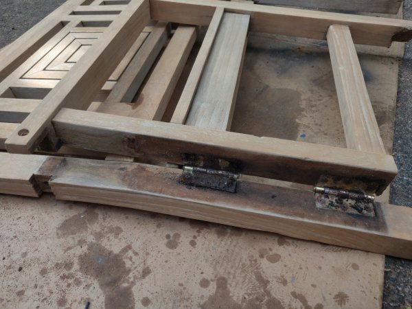

    The hinges have seen better days......

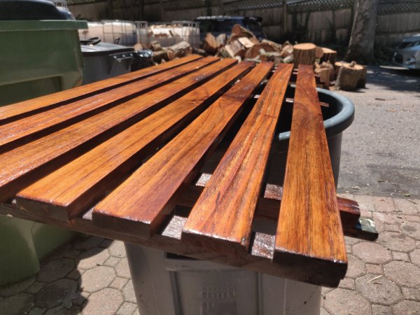

    3rd coat of teak oil freshly applied to the first bench........
    Aw yeah.........
    Yes sir........

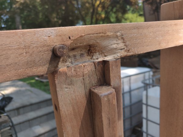

    Rotted area where the clasp attaches to.....

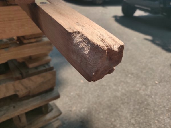

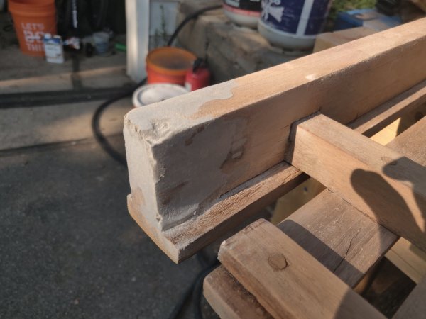

    Dry rotted leg scraped clean.......
    More rotteness......

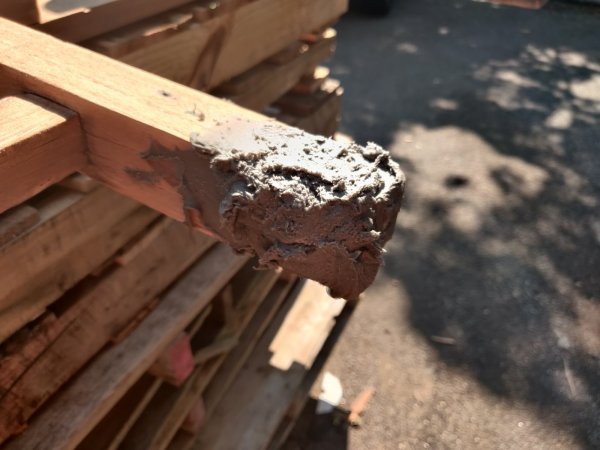

    First coat of bondo.........
    2020-07-02 16.31.40 - Copy.jpg 2020-07-02 16.31.45.jpg 2020-07-02 16.31.51 - Copy.jpg

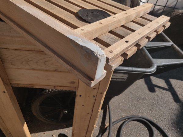

    After some sanding........ended up doing 3 coats (finer and finer each time.....)
    2020-07-02 16.51.55 - Copy.jpg 2020-07-02 17.40.48 - Copy.jpg 2020-07-02 17.40.52 - Copy.jpg 2020-07-02 17.40.57.jpg
    Final pic of the first bench.......Still need 2 more coats of teak oil on the 2nd bench..........

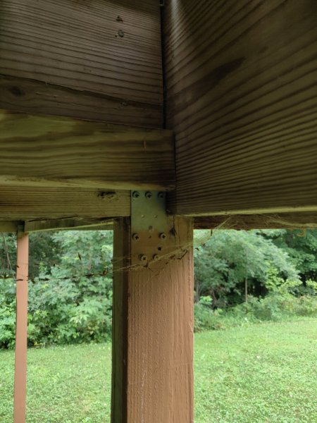

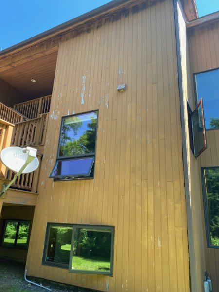

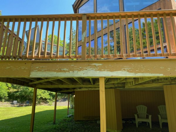

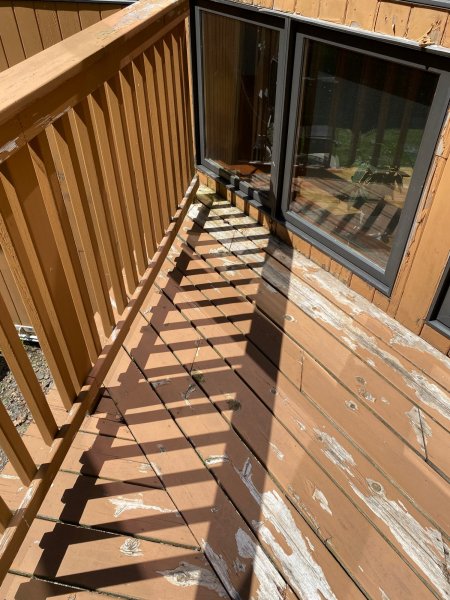

    Hey Ashwatcher, what did you do to the cedar siding after "watching" it with the oxalic acid? Did you leave it "au naturel"? Or....... ? I have a buddy who just bought a ginormous house and the previous owner painted over the cedar siding 3 years ago.....My buddy had some health issues and in those 3 years the paint is just horrible. They also installed a deck whose railings wobble about 3" and you won't find any joist hangers on the support system nor any concrete footings. Needless to say I told my buddy he HAS to tear down the entire deck asap and rebuild it properly or else someone is going to get killed.
    Here's a few pictures of the house.......
    6174696741_20200726_115325.jpg 6174696951_20200726_115322.jpg 6174697421_20200726_115421.jpg 6174697611_20200726_115423.jpg 6174699471_20200726_115437.jpg

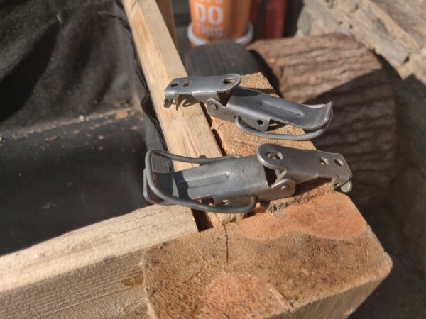

    I also brought the clasps back to life by soaking in 5% cleaning vinegar for about a week or so. Wire brush, WD-40, and a wire wheel as well........

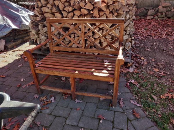

    Finally got around to putting the second bench together. I think this shall work just fine....except I don't know about this teak oil. The first bench has really lightened up a lot and it's already sitting under a canopy of 75ft oaks and a few huge japanese maples....so it's not even in direct sunlight for most of the day.
    Now the first bench was a bit lighter to begin with but it has gotten noticeably lighter since and I already need to touch it up before the winter comes.
    2020-11-07 12.58.42.jpg 2020-11-07 12.58.49.jpg 2020-11-07 12.58.51.jpg 2020-11-07 12.58.56.jpg
    Here's the first bench.
