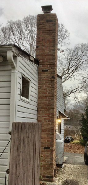

    I've decided to replace my masonry chimney with a stainless one after this heating season. I want to plan and gather materials over the winter/ spring.
    The old one is in good condition but I want to clean it from the ground,from the bottom of a T with a drill.
    I built the old chimney in the 70's. First with those square cement blocks with a hole for the flue tile. Was new to wood burning and bought the original Vermont castings Defiant stove. Years later I covered the cement blocks on 3 sides with brick.
    Not too worried about removing the old one. I'll take it down in chunks dropping to the ground. If necessary I will use an excavator to carefully bring down chunks.
    The removal and installation don't really worry me.
    I need advice on which stainless chimney system to put in.
    I think I remember that double wall is better than triple and some manufacturers make several of the name brands you see for sale
    Duravent, metalbest, ventis, super vent at Lowe's with (Supervent 11 piece kit)
    I've looked at Harts website and at tractor supply with their triple wall.
    Height from where pipe goes thru wall is around 15 ft
    Would appreciate any advice and knowledge from the forum!

    Nothing wrong with it really. I get more creosote because its masonry and colder but the main reason is I just turned 70 and think it would be better for the future to be cleaning chimney from the bottom. I am still fine with going up and cleaning But for how much longer?

    Thinking about this...
    I suppose I could cut in a another clean out door much higher and just below the T. Then I could clean up with the soot eater rods and a drill.
    I thought to get the insulated liner in I'd have to break out the clay liner to make room for it.
    My neighbor had it done for his oil burner chimney and they couldn't fit the insulated one down with the clay liner in place.

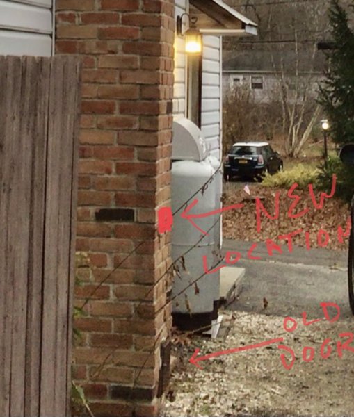

    I would investigate the raising clean out option first..
    My insurance made me build a chase around my double wall due to winds. I like brick better than siding.

    Exactly what I'm thinking now. Glad I posted here. Thought we'd be talking about different manufacturers.
    But thread took a turn I never expected.
    When I talked to my wife about a new chimney, her comment was it's gonna cost a lot right?
    Now, moving clean out door up higher will allow me to clean from below easily and more often.
    Even without liner of any other changes. just have to get a good clean out door that seals well.
    Think I should leave the lower door or fill chimney below new door?
    Horkn and mat60 like this.
  15. Canadian border VT
    17,614
    114,699
    I would probably fill it as 2 doors could create some odd drafts or air leaks plus home for critters.

    To install new clean out door I have to cut thru 4 inches of brick, 4 inches of concrete block and clay liner maybe 1 inch.
