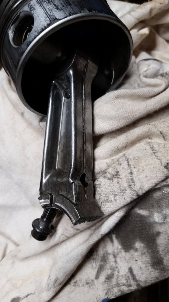

    My smaller Toro snowblower threw the connecting rod or something today. I replaced the crankshaft and rod a season or so back and it ran great. I had a washer on the top of the engine rust, split and vibrate out at the end of last season and it was blowing out of the head gasket. I think maybe the damage was partially done then. I replaced the head gasket and new washers under all the bolts yesterday. I tried it today and it sounded good. I walked away to let it warm up and heard the clack-a-lack death sound and ka-chunk.

  16. fishingpol
    fishingpol
    6,502
    39,641
    Merrimack Valley, Ma.
  17. fishingpol
    fishingpol
    6,502
    39,641
    Where's my JB Weld?:whistle:
    No surprise here.:rolleyes:
    Hammy, brenndatomu, Barcroftb and 2 others like this.

    Are you sure that's not one of those fancy "cracked connecting rods" ? Lol
