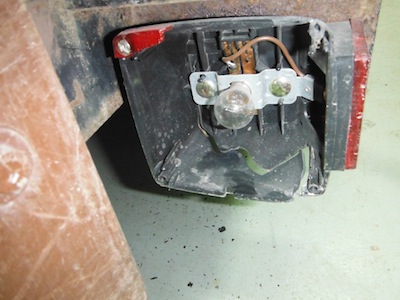

  1. bogydave
    Broken tail light.
    I seem to break one or 2 every year.
    The wood area has no real goo turn arounds for a 16" trailer.
    Been saving the parts.
    used some duct tape & a red lens off an old one to get this one looking better. Fits close enough.
    Most likely I'll break it next year anyway.

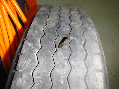

  2. bogydave

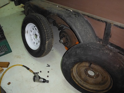

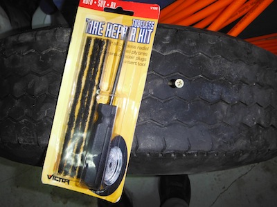

    Remember the flat tire on the trailer
    Time to fix it.
    Using a plug.

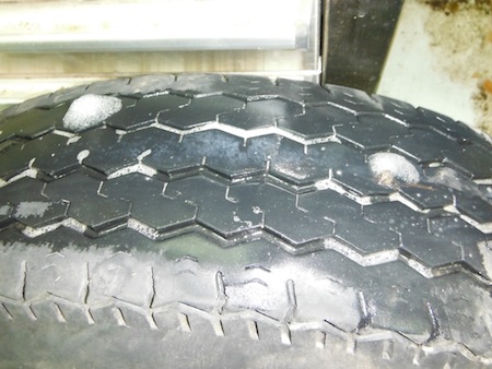

    Fill & test:
    AARG, it leaks, & I found at least 4 other leaks.
    Called the tires shop, $ 128 for a new tire. Told them I only wanted one, they said $128.
    To the auto store for a tube. $18

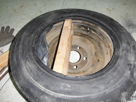

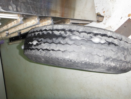

  3. bogydave
    To/from the store for a tube.
    Break the bead with the hammer bead breaker,
    roll one side off the wheel, (used dawn dish soap to help)
    Install tube, inflate , remove the spare & put it back on the trailer spare mount.
    A simple tire job turned into an several hour repair.
    Noticed 2 other tires have tubes, maybe their about worn out.
    Hope to get a few more years out of them.
    Was also planning to grease the bearing & check/ adj the brakes.
    Maybe tomorrow or Monday.
    to be continued :

  11. bogydave
    I didn't want to replace the light fixture, it is working. LOL :)
    Think I'll try mounting them on top of the angle next time. (pretty sure there'll be a next time )
    Other side is broke too, but not so bad it needs replaced, + it helps as a back up light :)
    These were both new this year. No need to buy the expensive ones, they'd get broke too.
    If I had a welder I'd put a guard around it. But
    I bet I could still break them.

  13. bogydave
    I keep saying I'm gonna cut some of the trees & brush to make a good turn-around
    Need to make it a higher priority next year,
    tail light replacements & repairs are getting old.
    Yea, was gonna take it to the tire shop
    they closed early on Sat. & the auto parts store had a tube.
    The tire hammer's not too bad but the 6 ply tire was real stiff,
    Used a couple 2x4s to pry it open to put the tube in.
    Lots easier than an ATV tire by a long ways :)
    Stinny and Backwoods Savage like this.

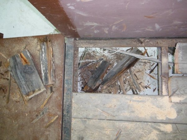

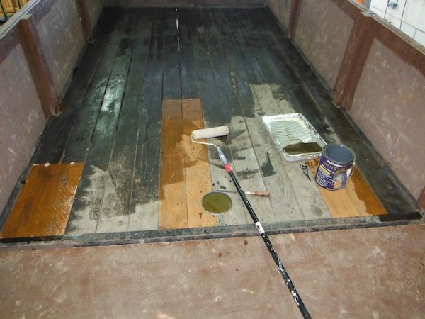

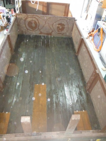

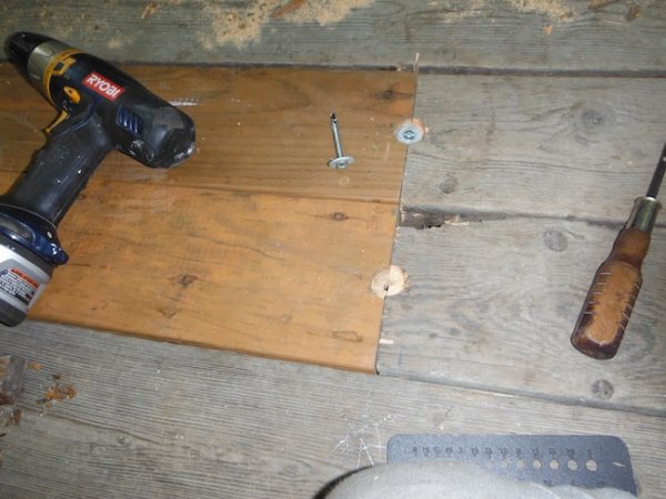

    Cut/removed/replaced some of the rotten deck boards.
    Just spliced in some short peices. No need to buy new 16' treated bords yet,
    Should get a few more years out of the deck now.
    Had some man-o-war deck stain. Figured it might help water resistance.
    Maybe help the wood last longer.
    Nice day , worked with the garage door open.
    Trailer done,
    parked out back, out of the way for winter.
    The pictures:
    On to another project :)

  19. bigbarf48
    bigbarf48
    Sep 25, 2014
    2,344
    4,701
    Stone Mountain, GA
    Deck looks good dave :thumbs:
  20. HDRock
    17,249
    60,361
    how thick are them boards?
