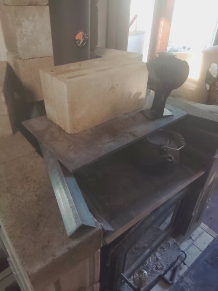

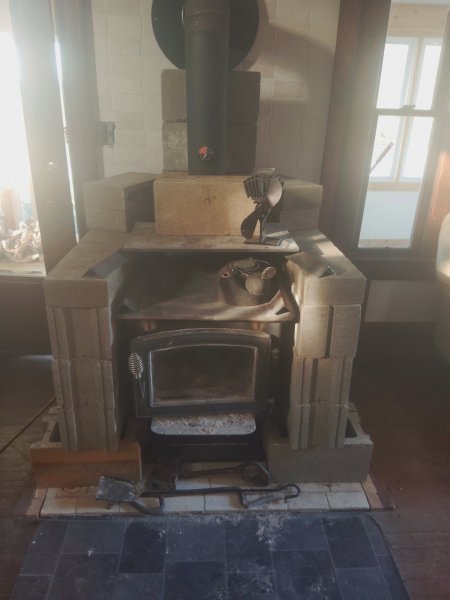

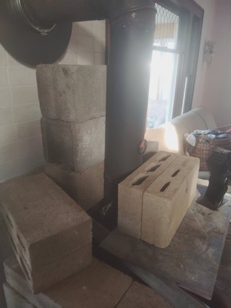

    Last season I experimented with thermal mass.
    Roughly 1500 lbs of cinder block.
    Alot of people on here told me it did nothing, waste of time, ect.
    It was good for about 5f gain average through the season.
    My thoughts on why it works for me are
    1 my house is old, big and drafty.
    If I'm pumping a bunch of heat into the air it gets "blown" out quickly.
    With the thermal mass it's radiating heat slowly so therefore it doesn't blow out as fast.
    2 I tend to be gone long amounts of time so I really stretch my reload times.
    The stone helps keep a little warmth on them long stretches.
    Anyway, I redesigned it for this season with the exact same things that were on it last year, but I gained my access to my stovetop back so I can cook on it again.
    Not sure if the fan will get enough heat up there to operate but we will find out soon IMG_20251026_165835.jpg IMG_20251026_165842.jpg IMG_20251026_165856.jpg

    Interesting. You created somewhat similar setup to an insert in a fireplace, which is what I have. Should work OK for you if you liked how it performed last year. . Let us know.

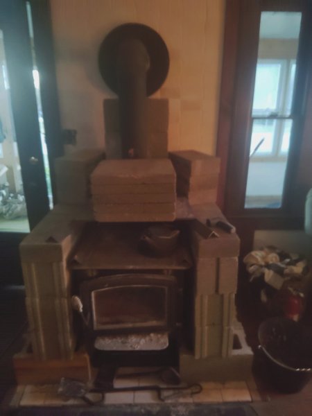

    Actually found some more blocks from when I had to replace my sewer line.
    Guessing 20lbs each so another 100 of mass gonna burn a small fire tonight IMG_20251026_184541.jpg

    That's known as convective, vs radiant heat...with a drafty house, radiant heat would feel better.
  5. Dunmyer mowing llc
    Dunmyer mowing llc
    Sep 26, 2023
    508
    3,375
    Indiana
    Convective being a stove that heats the air correct?
    Now we would see higher peak temps pre thermal mass, but this way it is a higher average temp inside the house
