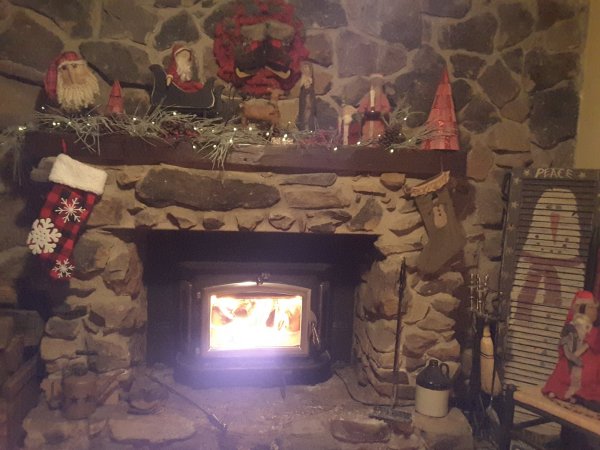

    20171224_231850.jpg Buck stove 91 on Christmas eve.
    FatBoy85, Satchmo1960, Horkn and 3 others like this.
