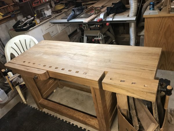

    When I built my workbench last year, I enclosed the base with panels for an eventual drawer case.

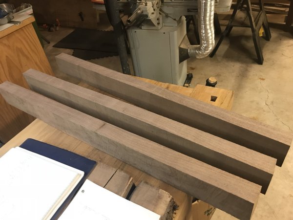

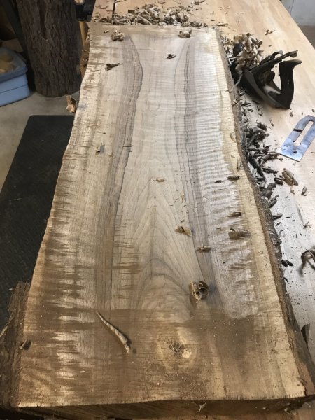

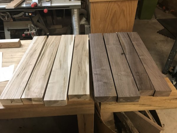

    The face frame for the case is going to be black walnut, and the drawer faces will be curly English walnut. Both came from trees at my sister’s house that I chainsaw milled a couple years ago.

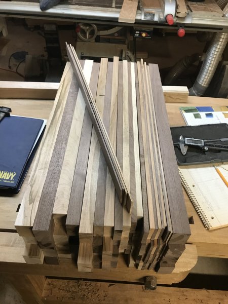

    The cutting boards are going to be this pattern again. I’m hoping to get 4 of them but I may only end up with enough for 3 out of this batch. One of them is going to my mechanic in payment for a new drivers side mirror for my truck. The other ones aren’t officially spoken for yet but I think they’re going to go fast... ;)
    20F78646-DA79-44B8-80FF-8B5A63F16DAF.jpeg 86498C73-1468-44D9-8A1B-F6FB155D3DFE.jpeg
    I made a video of my milling process. The pattern consists of 23 strips with 11 different thicknesses. In fact, 2 sets of them are required, the second one being the color inverse of the first.
