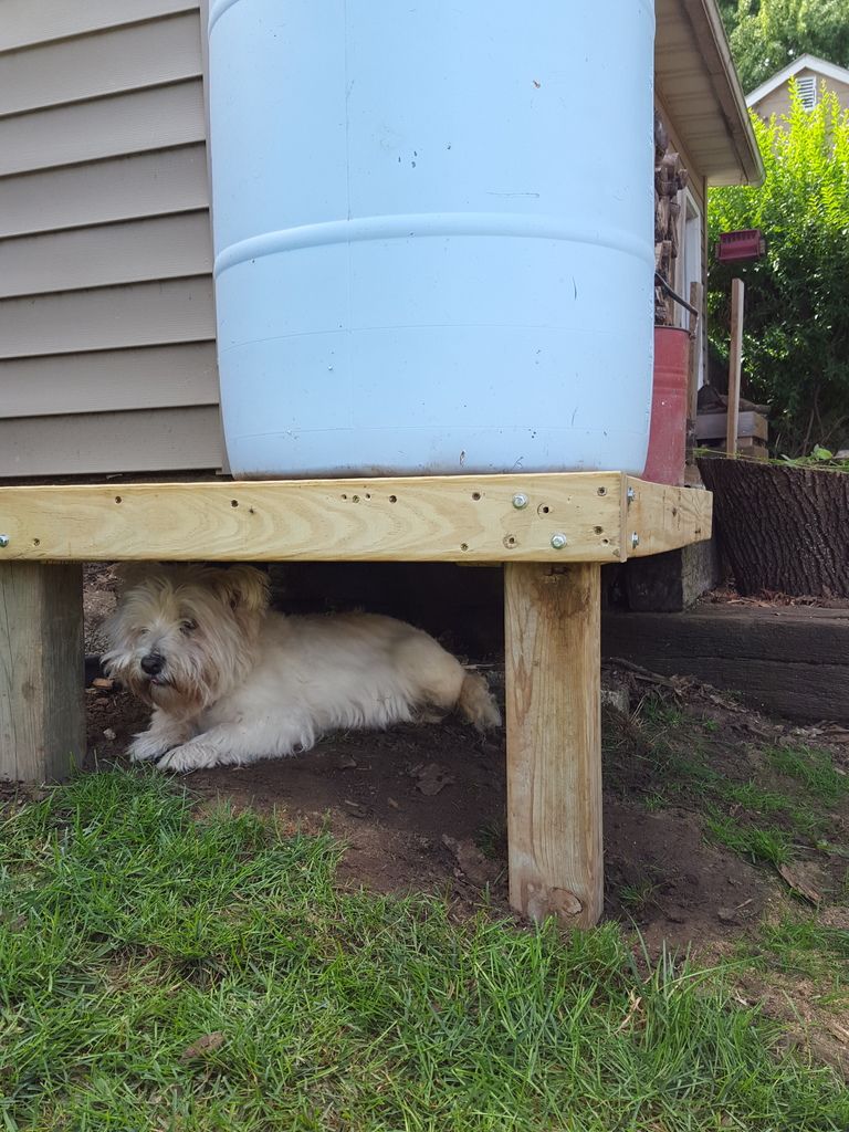

    My "green" bride has always wanted a rain barrel. So this morning I built the platform for it.
    To be extra green everything but a few screws and lag bolts were reclaimed.
    Old deck boards make up the 36"x30" platform.
    The sides are scrap 2x4 for extra strength.
    Boxed in the junk treated 4x4 legs with notched scrap 2x6s.
    Spiked in the one end into the landscape timber. Obviously the platform had to be inspected and certified by my dogs.
    An old repainted poly 55 gallon drum sits easily in top. Next up, modifying the drum and downspout.
    That is after Flicka gets done with her extended inspection of course. :)

  2. papadave
    82,468
    We've amassed a total of two, yes two, rain barrels. Just haven't made the time yet. I have a perfect spot for one of 'em, but it could actually use more than one easily.
    Funny, she doesn't look like a horse.............. :D

    Nice job bud, my honey has wanted one too very interested to see the finished project :thumbs:

    I see in pic 4 the weight testing was happening.

    Lol. She was, like the other two in that picture above, a rescue dog and is 13. We'về had her about 3.5 years now and still haven't figured out why they named her that. Although she is as stubborn as a mule. :)

    Nice job :thumbs:, ya know it's good if the inspectors certified it :D

    Great "green" project, well inspected and documented - wouldn't expect anything less than that! :thumbs::thumbs::thumbs:

    Looks nice.
    But...if I did that the same way here, I would have a platform that would be settling into the ground without any type of base for those legs. Maybe just a patio block?

    Great point. I'm actually using it as an experiment. What can I say, I'm a nerd.
    It's a hard packed area because of the construction of the garage next to it. I calculated the bearing pressure to be around 1360 pounds per square foot which is less than almost everything we see for a bearing pressure for footings in this area. Granted it's a different stratum, but it's a good baseline to compare to.
    Besides, if it does settle I will just simply lift the filled tank off the platform with one hand, lift up the platform with my other hand and put a block under each 4x4 with my third hand. :)

    That would do it. plus it keeps the wood off the ground.
