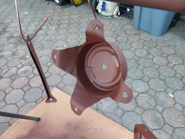

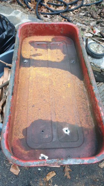

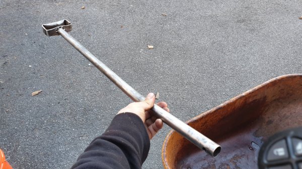

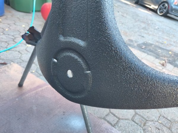

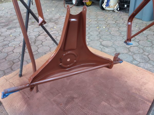

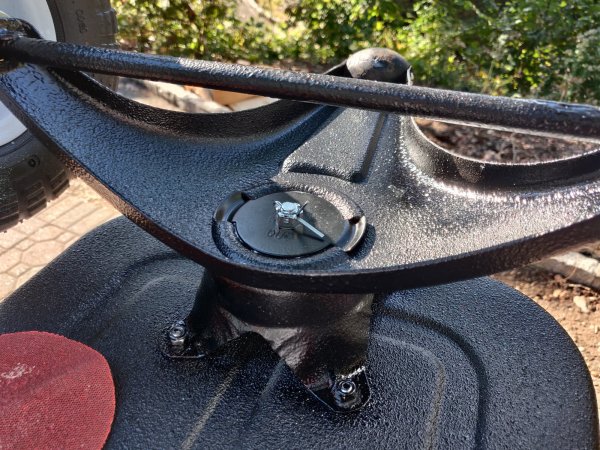

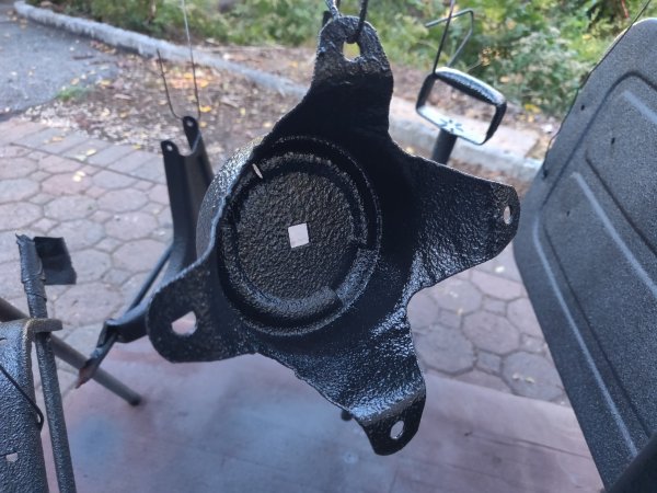

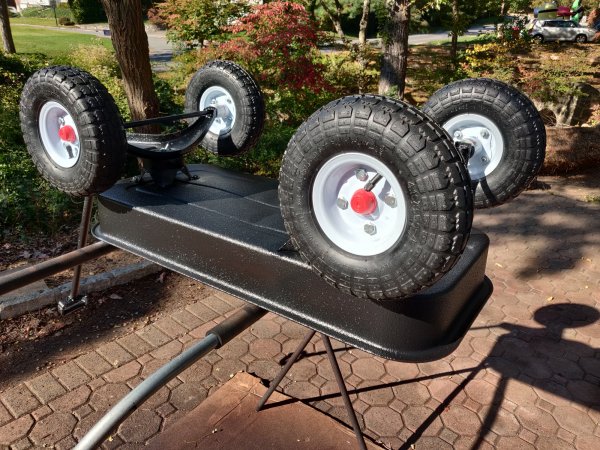

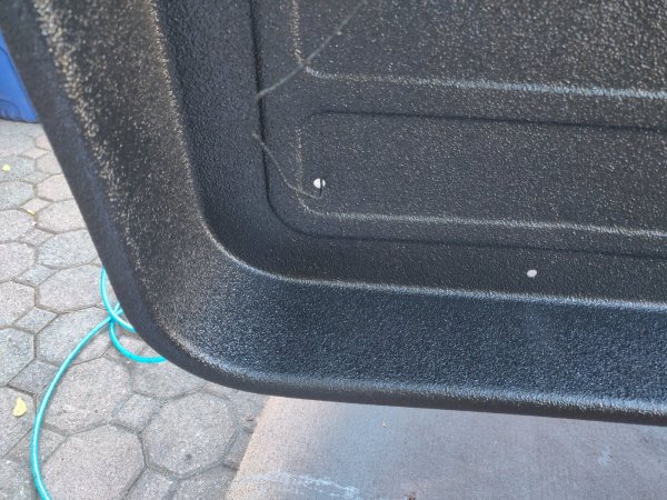

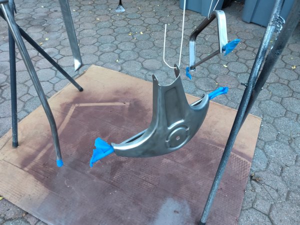

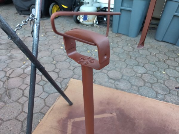

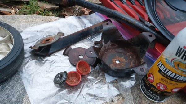

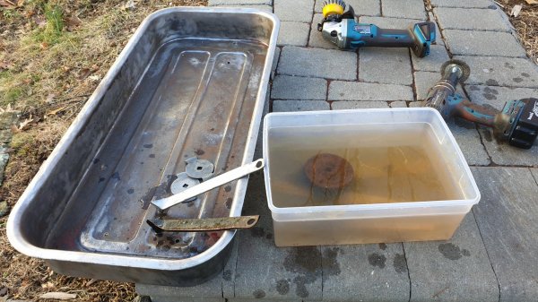

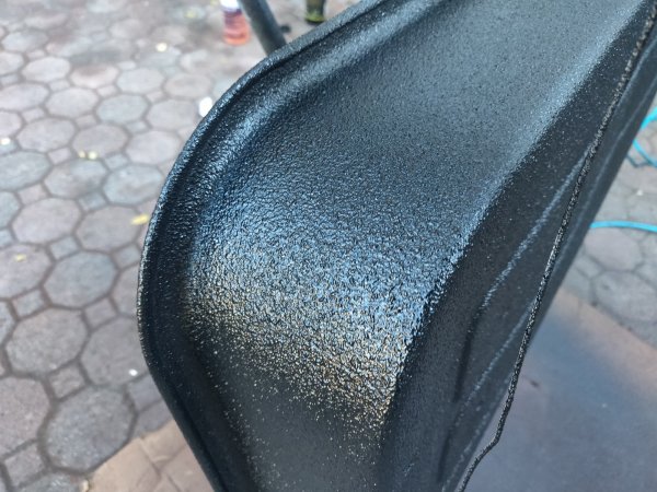

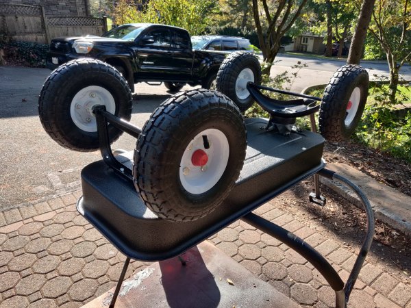

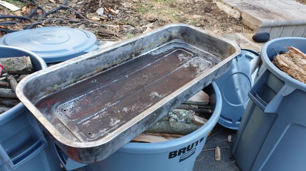

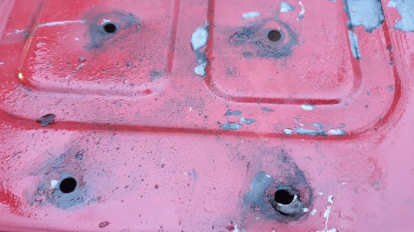

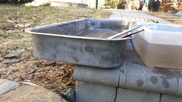

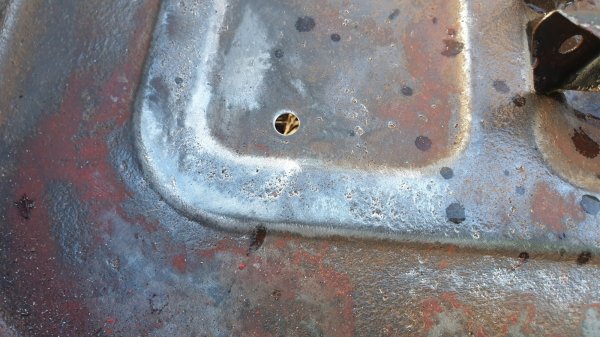

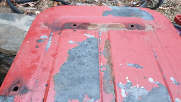

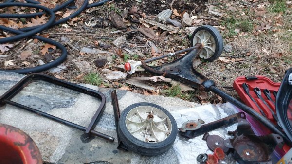

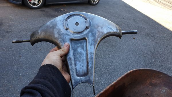

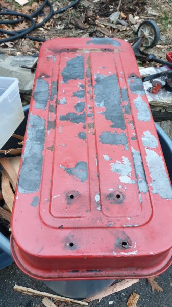

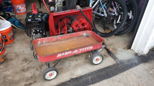

    I found this in the trash on Jan-6-2020.

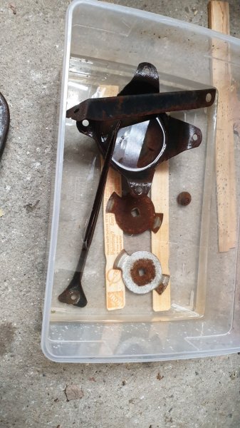

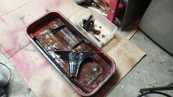

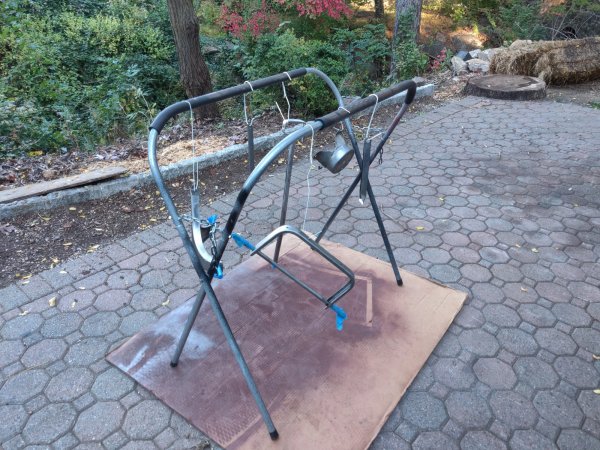

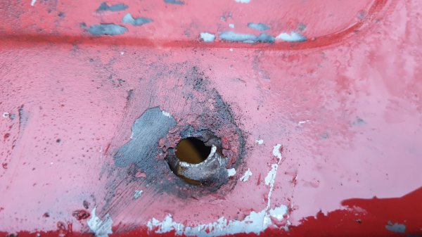

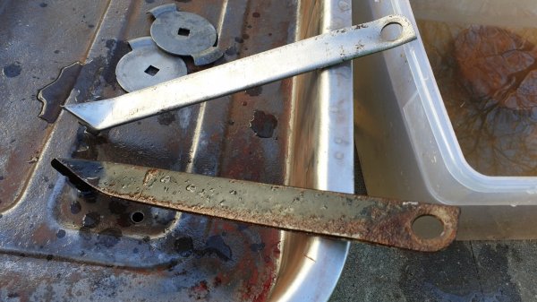

    Stripped all the paint with a combo of a wire wheel, wd-40, brush, vinegar soak and then put it aside for a while.

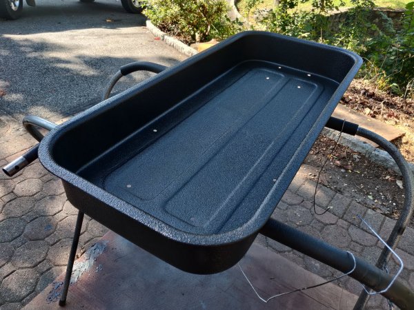

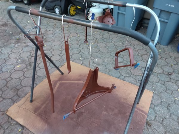

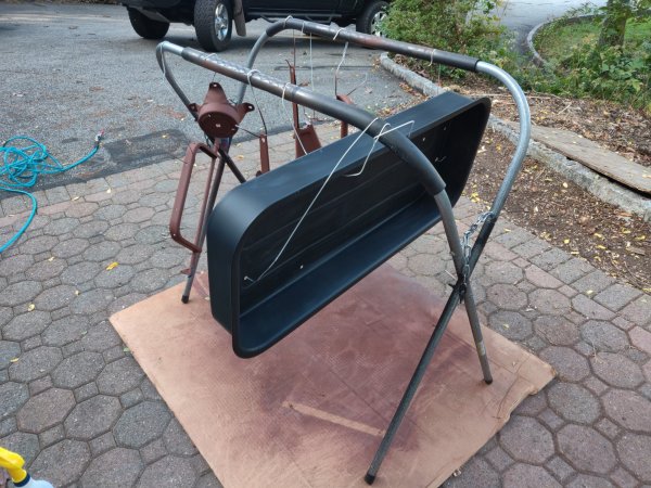

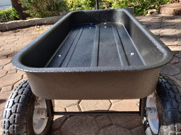

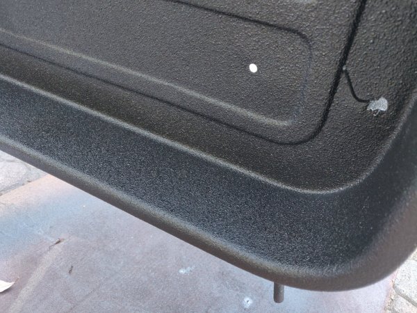

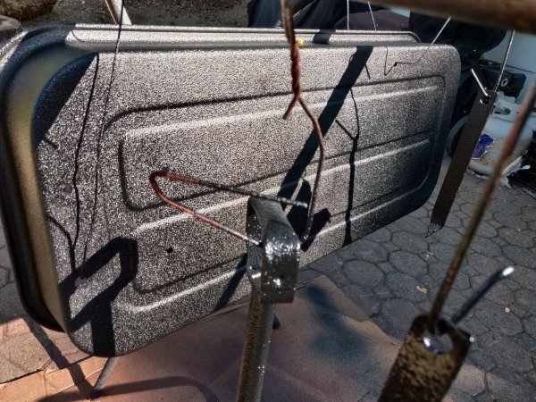

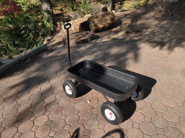

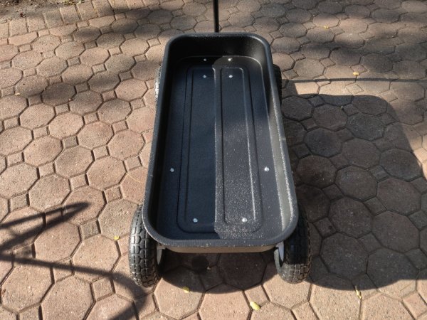

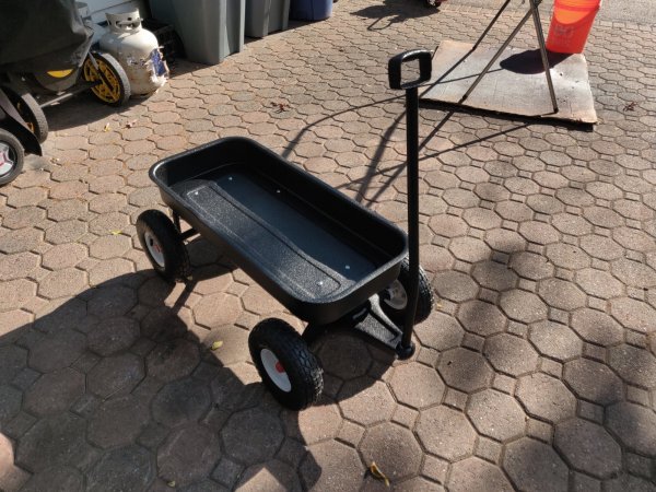

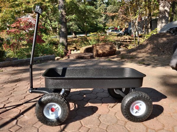

    Cleaned it up the other day again with some vinegar soaking, some denatured alcohol, and then primed it and painted it today with U-pol 2-part truck bed liner leftover from spraying my new side steps on my truck.

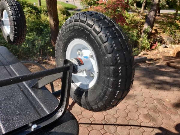

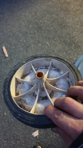

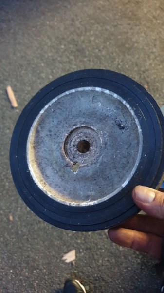

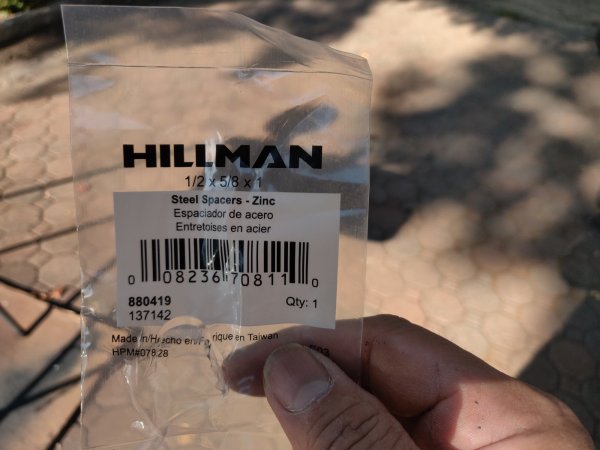

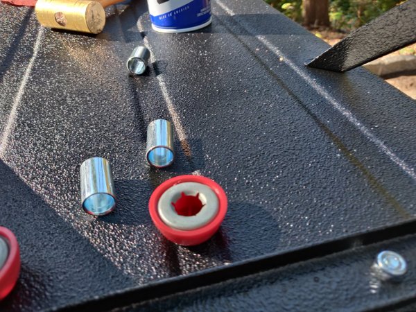

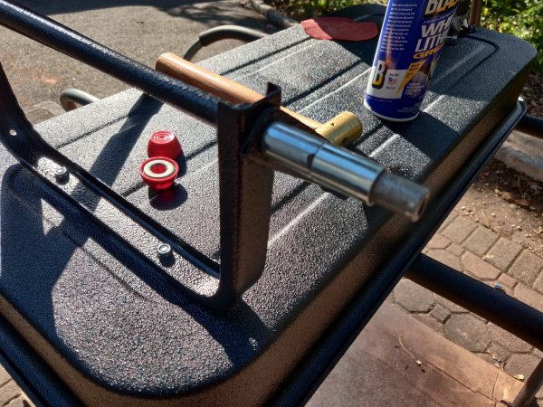

    I also ditched the original plastic wheels which were broken and opted for some nice 12" HarborFreight wheels and tires with tubes.

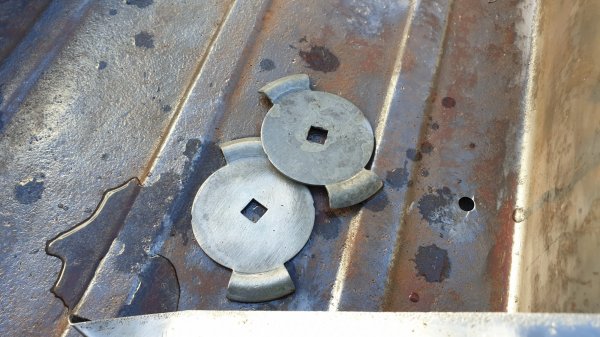

    Had to get some 1/2"=> 5/8" sleeves as the old axle is too small for the new wheels.
    I also bought a hardware kit from them. Perfect replacement.
    I'd say it came out pretty f-ing awesome.
    I'm giving it to my neighbor who is expecting his second son in November.
    Part 1 of the pics.

    And here is what I did today.

    Nice rescue and rebuild!
  5. Woodwidow
    14,731
    91,090
    That looks great. The kid is going to love using that. With those wheels, he will be able to haul firewood in it.

    Is that a powder coat paint job? Looks really sweet and the wheels are the cherry on top.
    LordOfTheFlies likes this.
  12. LordOfTheFlies
    LordOfTheFlies
    Apr 5, 2019
    2,519
    12,097
    NY
    Thanks! Rust-o-leum rusty metal primer then U-pol two part truck bed liner from Amazon (included the spray gun). I used the same stuff on my side steps of my truck and not one piece of rust or chippage on them thus far.
