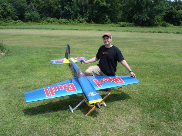

    The big one on the left is my pride and joy. Its a 30% scale model of a Zivko Edge 540 aerobatic plane. If you have ever seen the Red Bull air races, you get the idea. Our models are even crazier though. The plane has a wingspan of 85 inches (7ft), weighs just under 17 lb with fuel and is powered by a 50cc 2 stroke gasoline motor that swings a 23 inch prop capable of generating 26 lb of thrust. Its not a fast aircraft though, top speed is probably around 75mph.
    Yes, that is not a misprint. This thing has a better power to weight ratio than an F-18 :D
    This allows us to do stunt flying we call "3D aerobatics" where we can do things the real aircraft is incapable of such as hover from the prop like a helicopter.
    And this is the real one from a few years back. I used a lighter metallic blue.

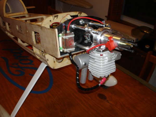

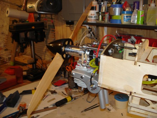

    I figured a bunch of saw nuts might like to hear more about that engine. In the old days we would use converted chainsaw motors for hte big planes but for many years now we have had a variety of purpose build R/C gas engines. This one is called a Desert Aircraft DA-50R. Its built in Arizona with an all aluminum custom cast jug and CNC machined case, specially made auto advance electronic ignition that runs on battery. Its a standard 2 stroke design with reed valve case induction and an off the shelf walbro carb.
    The engine weighs something like 3lb bare - just under 4 with the ignition, battery and the custom aluminum muffler. It makes about 5hp at 7000 rpm.
    The fuel line fitting you see on the muffler is a smoke generator. We have an onboard pump that injects kerosene based fluid into the muffler to make smoke just like full scale airshows.
    The black firewall is a composite sandwich of carbon fiber and end grain balsa, as stiff as 3/8 aircraft plywood but a faction of the weight (2oz vs 10). Similarly that prop spinner is a thin carbon cone screwed to a hollowed out aluminum backplate. The plane has carbon fiber in other dritical locations as well like the main wing spar. All to make things light.
    Note, this is not overkill (tm). They make these things up to 4 cylinders and over 200cc. Even radials and 4 stroke models. The models guys build for those are staggeringly huge and you can imagine how expensive.

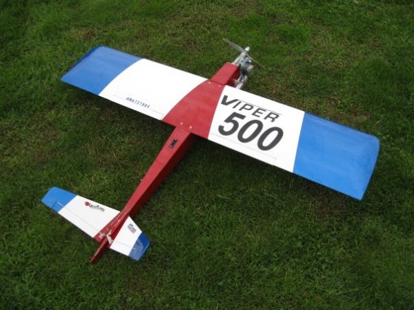

    Sometimes we dont want to do stunts, but rather just go fast. This is my race plane. Its small (about 4ft) and uses a traditional alchohol burning model airplane engine. Again 2 stroke, 0.46ci displacement (7.5 cc) that turns a tiny 8 inch prop at 16,000 rpm for about 1.5 hp. It will do just under 120mph and blow your ears out.
    I just fly this guy for fun. In the organized races it would not be competitive. They use $$$ custom race engines and can hit 150. And this is the entry class, big end stuff will do 200+ and the turbine jet guys can do over 250.

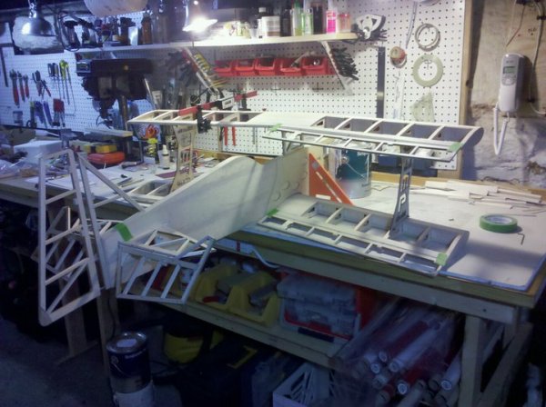

    Today most guys just buy models premade from China and slap on a motor. I still like to do things the old fashioned way and build. One of my other favorites is this Ultimate biplane. All balsa wood any ply with some foam and carbon fiber in critical spots.
    The power is a model 4 stroke engine. Its a hemi head :) 1.0 ci with pushrods and overhead valves, turning a 15in prop about 9000rpm. This one also has a more than 1-1 power to weight.

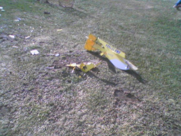

    Yeah when I was learning I ended up climbing trees a few times :) And every once in a while a mishap occurs, pilot error or equipment failure (though in the large expensive ones we use dual redundant batteries, switches, control links etc to reduce the risk). Knock on wood its been a couple years for me since the last mishap.
    And then sometimes you just have plain (pun) bad luck and have a mid air collision. Ive had three.
    The other guy ended up worse. Both planes where retired.
