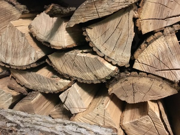

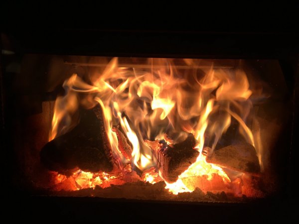

  16. Nigel
    Nigel
    Dec 4, 2017
    20
    78
    Ontario
    Yes, the foaming and sizzling is a relevant part of this discussion.
    I've now put a few "loads" through my mini-sauna/kiln room and subsequently through the stove (BK Sirocco).
    I can say that before being quick-dried, the wood can kick and scream and foam and sizzle, just like the old days with wet maple in the smoke dragon. Wood from after going through the drying process lights off extremely well, minimal kindling needed from a cold start, none needed if there's any speck of glowing coals. Gotta love ash!
    For the record, it takes about three days for me to extract 5 gallons of H2O from a 3/4 face cord of white ash. I'm sure someone could do some math... My testing shows average at around 22-25% going in. Coming out, certainly at the outside few inches it can be sub 20, I've seen 12%. Usually in the middle it's still around 20-22%. Yes this is at room temp, freshly splitting and measuring.
    Conclusions: I'm thinking it's well worth it, a few days with the dehumidifier on the wood. I bet it's helping with startup, reloads and efficiencies. Goes from "somewhat mediumly wet" to "somewhat mediumly dry, at least at the ends and very burnable" :)
