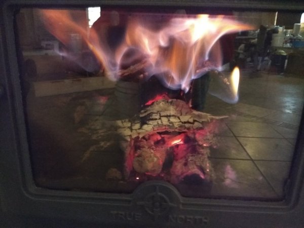

    The temp is at about 360 now. The air intake is closed the damper is open.
    The logs are almost gone. The flames pop up intermittently. Shall i wait until it's all ember or shall i put more logs on. Last night load can be around 23:00 or so, it's 20:13 now.

    Usually I’d have a nice bed of coals, fill it up, getting it going pretty good, then turn the air down and let it burn. Wake up at 6am and repeat if needed.

    I shoot for a reload around bedtime. At 3hr out and mild temps I would likely throw a few sticks in, and then load 20 minutes or so from lights-out. The few sticks will give some heat, but also ensure a good coal bed for a quicker load-to-cruise time.
