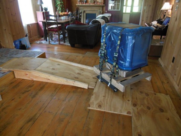

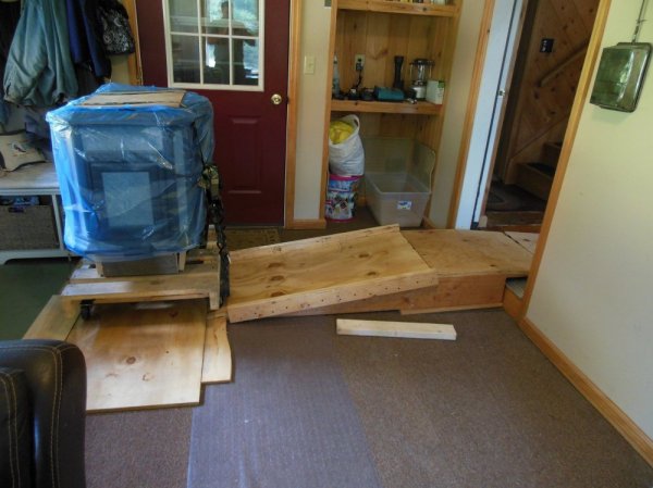

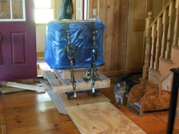

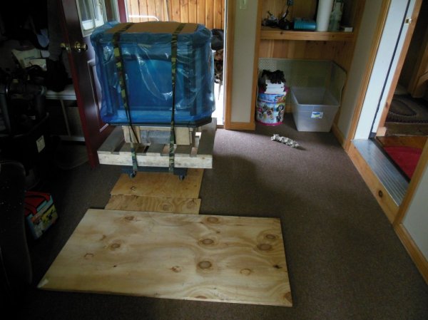

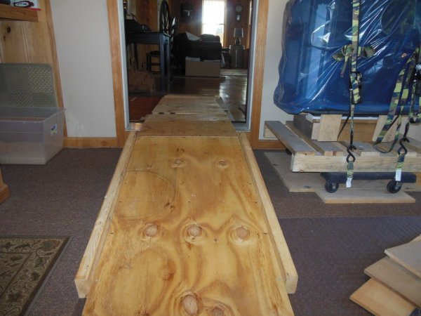

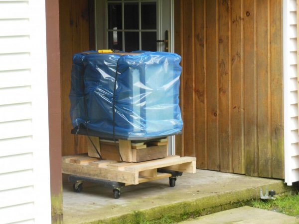

    I used a moveable ramp with sections of plywood to roll the PH up through my doorway and then moved the ramp to my hearth.. Even putting plywood on the ramp for the wheels to roll on as to not mar my brick. Being 47 miles away , you are welcome to the ramp I built,, it fits the PH to a tee.. Wife and I did the whole move, out with the Fireview and in with the PH.. I'll post the hearth move pictures next.

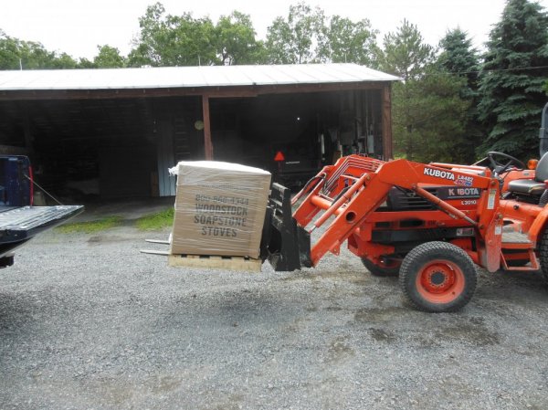

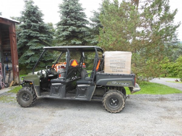

    Hearth ramp 002.JPG Progress move 003.JPG Progress move 006.JPG Progress move 012.JPG Progress move 015.JPG

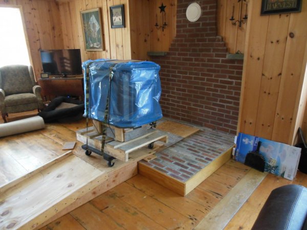

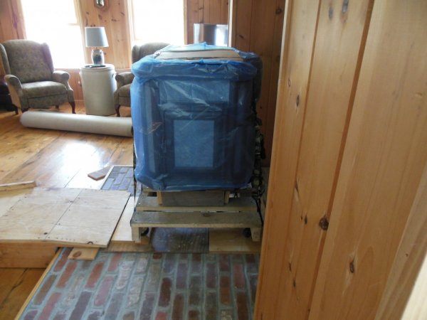

    Now the move from inside to the hearth.... I have more pictures putting the legs , shimming the stove up to remove the pallet, etc; if you need to see what I did.. Again, no damage to anything,, and the wife and I did it all, just worked smart...
