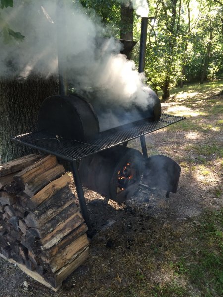

  13. fox9988
    fox9988
    2,709
    8,275
    NW Arkansas 72717
    But if you're using the little flavoring chips, wet may be fine.
