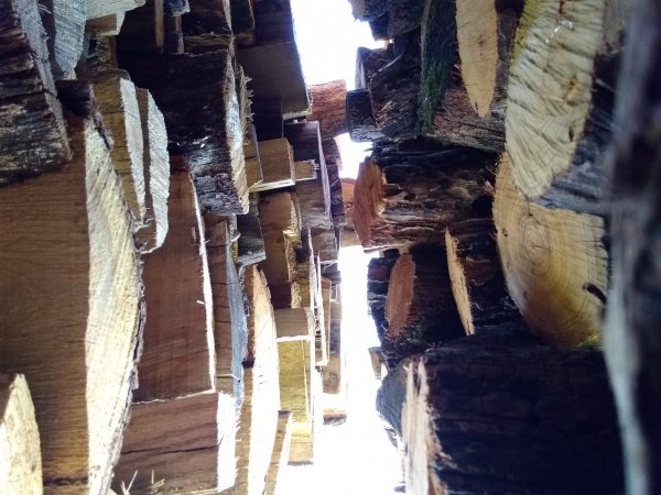

    Artistic shot, taken by my daughter, showing the inter-row gap. It works for me. Next up is a roof over the wood pile. There is a concrete slab under the pile that used to be a summer kitchen on the back of a long gone house.

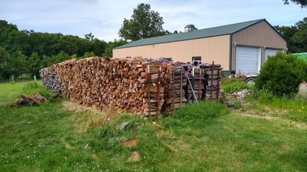

    This is how we stack and the wood has no problems drying. Most times I split and stack in spring then top cover in fall.

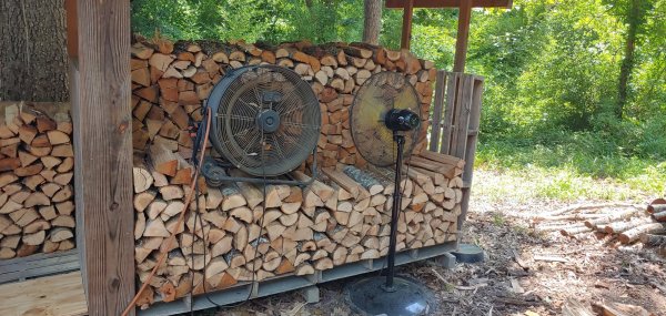

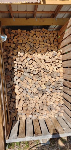

    We use fans to help speed up the process, especially with oak.
    Stacked 3 deep, you can feel the air coming thru the stacks, and it's much cooler than air going it.
