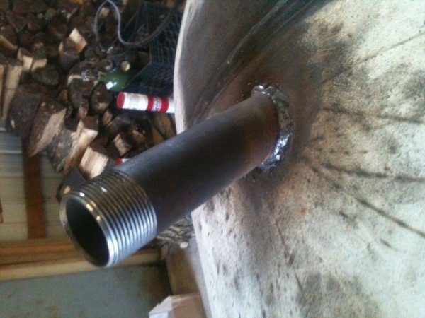

  4. coal reaper
    coal reaper
    1,138
    2,969
    Nj
    Good on yah. The bungs are much easier to weld than nippls.

  6. haveissues
    haveissues
    May 31, 2014
    641
    2,060
    Hudson Valley
    Nice shop! Mcmaster has bungs for a 36" curved tank. Figure they should work pretty well on a 30" tank, at least better than the flat ones.
