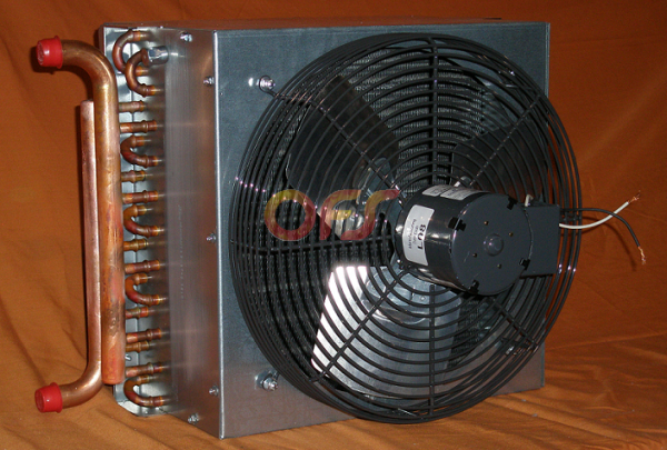

  11. Unicorn1
    Unicorn1
    Oct 31, 2013
    2,282
    8,917
    Amarillo, TX

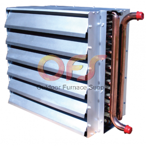

  12. Bags
    Bags
    Nov 16, 2015
    145
    431
    Union, KY
    Unicorn I have two of these H2O to air exchangers identical to the pics above. They come in different sizes for different size spaces obviously. How much are they selling for now? Most of these OWB's use the same units and parts etc; such as Pex tubing, these air handlers, Taco pumps, fittings and all so shop around for better deals and prices.
    What I am saying is the only brand / model specific parts are on the OWB's themselves like their control boards and electrical parts and stuff but many of these may be made at the same places also. The air handlers can run on their own house stats and the fan kicks off and on to the set temp on your stat. I run my Woodmaster and air handlers on zoned stats. 6 stats altogether. For example I have one of these in a two car garage and they are great for an all-in-one self contained unit.
    I also have one in the central HVAC system (heat pump) plenum and can heat thru my forced air and duct work. This one does not have the built in fan like pics above as it uses the blower on the HVAC system. It is just an fins and tubes unit that the water flows thru. I also did some radiant floors and feel that is the best overall but costly and not practical in many situations. One issue with the radiant floors is it takes awhile to get all the thermal mass up to temp if you start from cold. Much longer than forced air but it also heats much longer after you let the fire burn out.
    The ones in the garages and a shop area heat those areas to whatever I want but I usually have them dialed down some to say 55* - 60* which is fine for those places. If I want to be out there doing stuff and want it warmer I can crank the stat up. One thing I will say is the all-in-one H2O air handlers fans are a little loud but perfect in a garage or shop. I wouldn't want one inside the house if that helps. Really not loud at all in the right spaces. The sound is from the fans and can be toned down. Where I mounted mine I did so with thick rubber bushings which helped.
    I still have not looked at the previous link and read up on the Portage and Mains yet because the Time Warner cable < (can't stand them but I have limited options out where I live). The internet here has been not working well for days and running too slow. I'll check it out because this AM it seems to be functioning normally again.
    BTW the louvers on them are movable and adjustable so you can do what you want there for air direction. I mounted mine low and aimed the louvers down since warm air rises. Worked out well.

    The heat exchangers are 210K units @$920.
