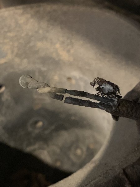

    That’s a tuff one for me since I’m color blind. I believe it’s red. Here’s the culprit.

  16. kappel15
    kappel15
    Sep 27, 2014
    96
    346
    Are you using a cover on that tc ?
  17. Marshal

    Yes sir! Just removed it for the picture.

  18. Snowy Rivers
    Snowy Rivers
    Nov 15, 2015
    2,849
    12,491
    Newberg, Oregon
    There certainly needs to be a ceramic cover that slips over the wire and protects it
    There should be a small metal bracket that slips under the rim of the fire pot where it contacts the firebox floor, and the little ceramic tube and TC slip into the bracket.
  19. Snowy Rivers
    Snowy Rivers
    Nov 15, 2015
    2,849
    12,491
    Newberg, Oregon
    Good chance that when you get the fresh TC in that things will work.
    The TC sends a small current to the controller to tell it if there is fire or not.
    Keep us in the loop on how it goes after you replace the TC
