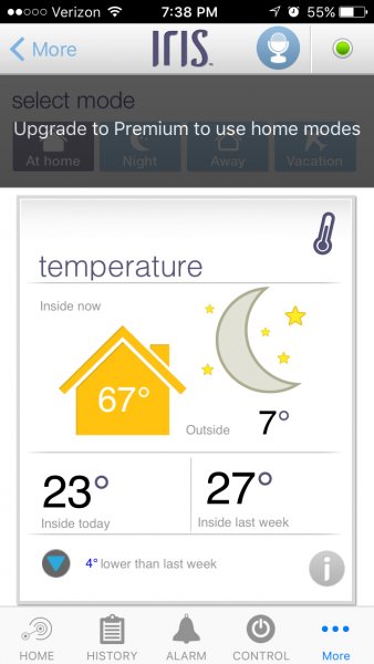

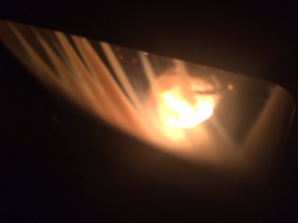

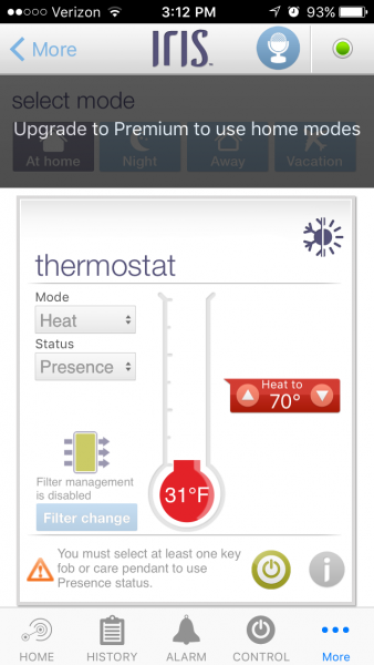

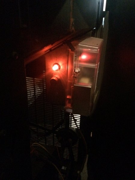

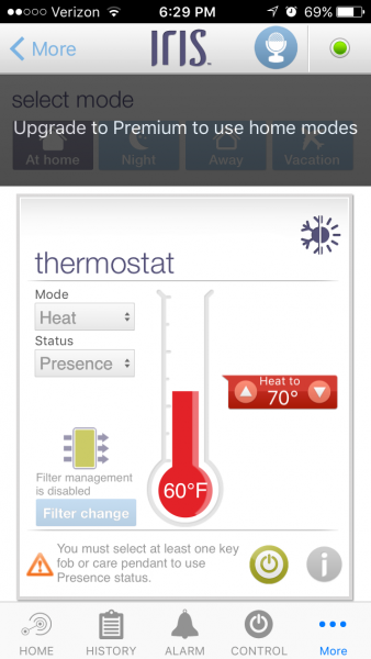

    Had to do some work in the shed today but 14 Deg F is a little uncomfortable. 4 Deg F outside the shed. So I pulled out the IPhone and turned on the Quad Contour and set it for a nicr comfy 70 Deg F. Went out to the shed and No Fire and no heat! The stove is clean and it has the updated clear control box so no CSS - cold start syndrome. Finally after hitting the reset button 3 times, it started fine but took many hours to warm the shed. The shed is only 100 sqft and very well insulated with R19 in the walls and ceiling.
    Granted most homes do not go down to 14 degs but cottages do so I was wondering if anyone has seen this problem?
    Pic 1 - iPhone shows starting temp in shed
    Pic 2 - shows call for heat light on the upgraded clear control box
    Pic 3 - shows fire finally after hitting reset 3 times
    Pic 4 - shows shed starting to get warm.
    Pic 5 - shows shed getting warmer..
