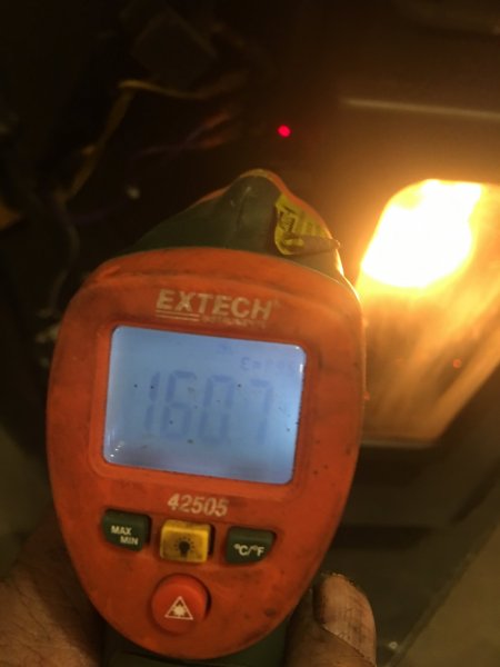

    So I dragged out the heat gun and got a Reading where Disc # 1 is located and got approx 133 Degs F ! This is too close to the low end of the spec for me since we are working with a bimetal Snap Disc not a super accurate digital circuit. I also measured the exhaust housing where most snap discs on other stoves are located and got 164 Degs F so if the more common 120 or 140 Deg F snaps were used, then the convection blower would stay running in this case!

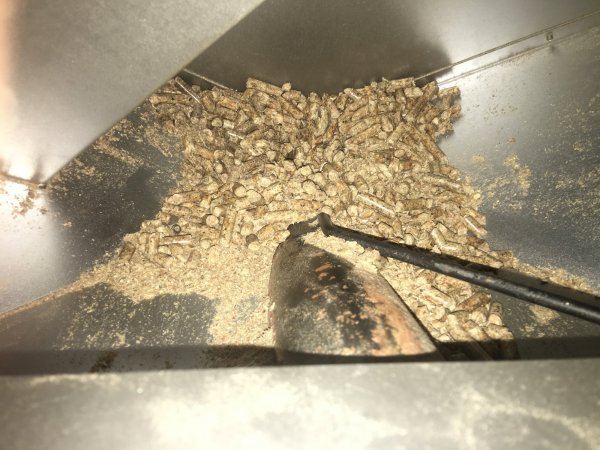

    It is burning some mystery pellets with a lot of fines that may have been sitting in the hopper for a long time! See pics
    It is a great stove and can burn anything but these pellets really do not look good!
    So today I will try fresh pellets.

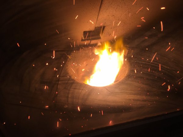

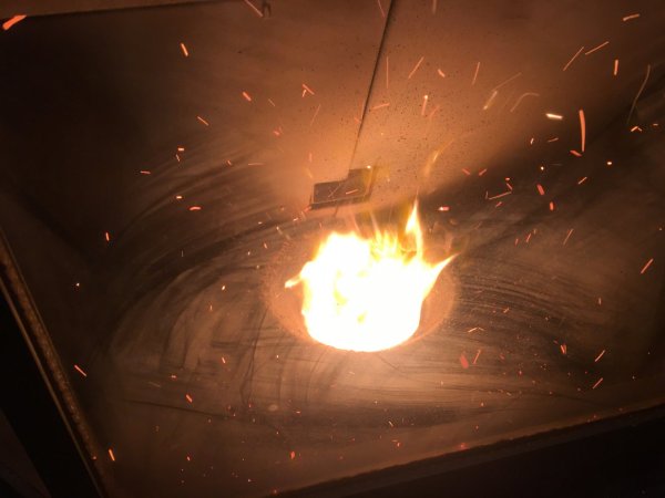

    I put in fresh new pellets and that made a big difference. It seems much better now. The flame is higher.

    Flame is higher with fresh dry pellets and Temp around the snap disc is higher now but not on low heat. On low heat the convection blower still drops out so the F127 Low Limit snap disc must be the best solution!
    127 +/- 20 gives 107 for the trigger so it should work fine.
    Goes to show how crappy pellets with moisture and sawdust do not burn as hot!
