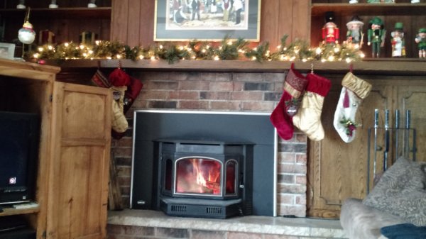

    Ok, I've got a Quadrafire 4100i. I've had it for 2 seasons now.
    I love it. It works well. It heats my entire 1700 sq ft ranch with good wood, in Wisconsin winters. My wife loves the bay/ bow window design. It will take up to 20" logs when loaded N/S. I get about 10 hours of burn time with the good stuff.
    It's quite simple to operate too.
    From when I first installed it.

    The quadrafire is a much nicer looking stove than the osburn.
    I put this 4100 in the place of an open FP with glass doors and a heatilator wood rack. I use about the same amount of wood as I used to with the open FP, but I can honestly say that my wood insert is my primary source of heat. I still have the NG furnace downstairs, but I really don't use that much anymore. I'll try the whole house fan in the HVAC from time to time if I get it a bit too hot and choochin' in the family room.
    I cut my gas bill down considerably by installing the quadrafire insert. So much that the stove paid for itself in year one. Granted I bought the stove used, and it was a smoking deal, but still.
