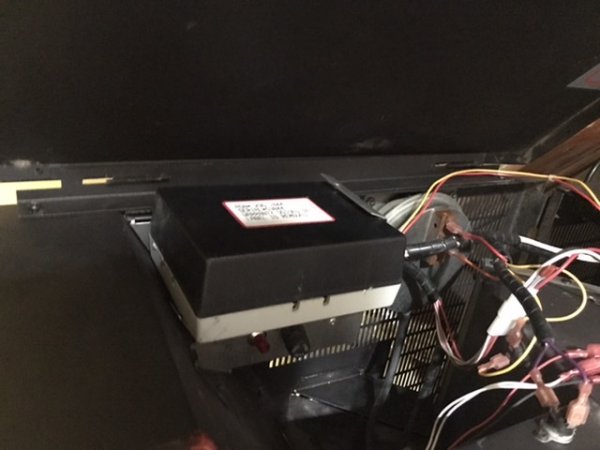

    May we confirm, is this the board? Sorry if we’re not sure:
    imacman and wildwest like this.
  14. slvrblkk
    slvrblkk
    6,647
    29,535
    Northampton, PA
    Yes, that is the control board.
