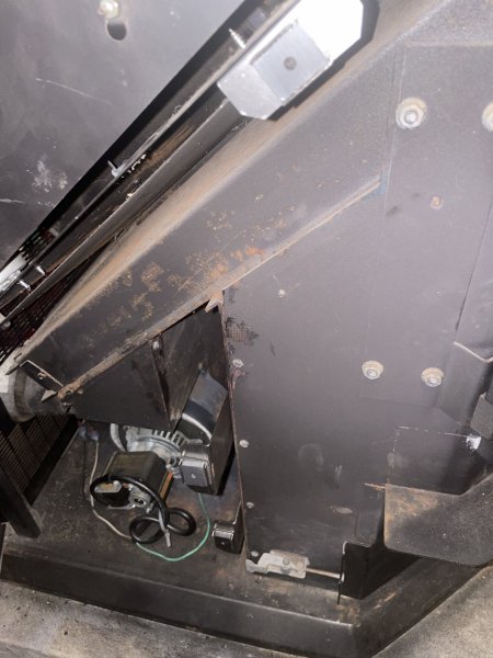

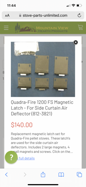

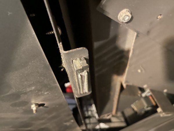

    I like the easy of servicing the magnetic latch side doors have. Unfortunately the older CB1200s have the side mounted magnets mounted in a plastic case the clips into the metal brackets. The plastic clips break and the plastic melts and warps from the heat! Fortunately there is an update kit. It is called:
    Quadra-Fire 1200 FS Magnetic Latch - For side curtain air deflector # 812-3821

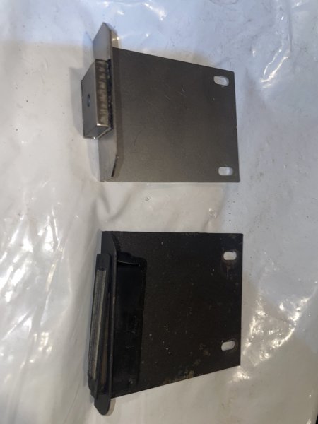

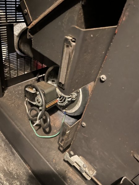

    These new magnetic latches have the magnets surface mounted with no plastic to melt or break! [​IMG]
    Now the doors stay closed!

    Pic 1-2 - Shows old latches
    Pic 3 - Updated magnet latch kit
    Pic 4 - New latch top VS Old latch bottom
    Pic 5 - Updated magnetic latches installed
