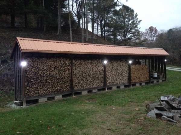

    Given papadave 's recent misfortune, I put up some motion activated LEDS-they glow dim dusk to dawn but kick out pretty good light when activated, will help out on those late winter night trips to the shed too image.jpeg image.jpeg

    Awesome shed!
    Those lights will be helpful pulling from the shed and security. Im gonna check them out as well.

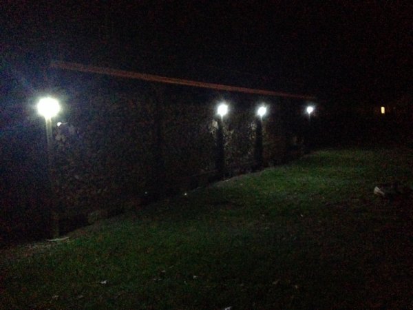

    Not so great pics but shown full on and the difference between dim and bright-I like them but we'll see how long they last

    Nice lights!

    That is a fine looking wood shed. How much does it hold? What are the dimensions if you don't mind. I'm still in the hunt for my new setup.

    Looks like they will do the job! Let us know how long they hold a charge

    Thank you-it is 4x40, expanded metal flooring and shadow boarded ends, faces south and the prevailing wind is from the west...each bay, double row stacked 6' high is 1 cord, I throw uglies in btwn the stacks to 3' so stuffed full it holds 6 cords---

    Woodchuck the first two pics were at daybreak this morning, they burn all night and they went out about 5 min after I took pic-It is important to let them fully charge before burning them-they have a keyhole switch which you insert a little pin to turn them on before they will accept charge-Best to put them up and turn on first thing in the morning on a day you expect full sun-so far so good
