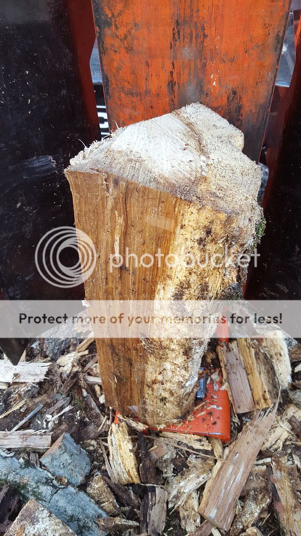

    So I've been working on some formerly standing dead red oak. The sap wood is completely punky and soaking wet, so I've been trying to trim it off with the splitter and/or an axe. So, what do all of you do in this situation, trim or just ignore? It sure slows me down alot.

    It'll dry. Just keep it top covered. If it comes off splitting that's great, but I don't make special effort to take it off.

    When I run into the punky stuff that is still attached, I remove it with a hand axe or the like. It is annoying and time consuming. If I can't salvage a large enough piece of wood after the punk is removed, it goes straight to the burn pit for bon fires.
    All the punk that is removed also goes to the pit.
    If I am at home and a piece turns up in the pile that I didn't catch before hand, it goes into the OWB as is.

    Get the bark off. When that sapwood gets punky like that on Red Oak the bark will be hiding all manner of bug grubs. Once the bark is off it's not a problem. The sapwood will dry out. And, yes, it really does slow down things.

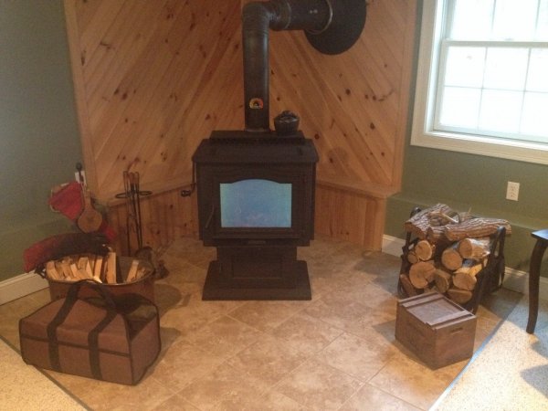

    90% of the trees I cut are dead standing Red Oak with some degree of punk sap wood. Most of it is an inch or less but some close to what you have there. I split it stack it and top cover it and it's good to go by next season.
    To keep from messing up the stove area I bought a nice little handy log bag to bring the punky stuff (90% if my wood) to the stove area.
    It's seems to me you are doing a lot of extra work by cleaning it for no gain.
    That's the log bag on the left .
    FatBoy85, Chaz, Elvisss222 and 9 others like this.

    I took a large red oak like that several years ago with the outer 4" of the trunk punky. At the time I didn't know what it would do, so I knocked off the punk with a Fiskars and let it dry. That punky wood dries so that it'll almost light with just a match! If I went through it all again, I probably wouldn't bother to knock off the punk, I'd just split the rounds like I normally would and give it a couple/few years to dry.

    I get a lot of that type wood. I typically run the splitter through the wood about an inch into the good part of the log. Doing this usually allows it to split cleanly. The punky split goes in the pile with the poplar for shoulder season, and the good part of the log goes into the three year plan stack. Nothing is wasted.
