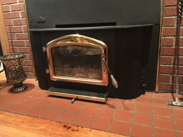

    A picture of you layout may help with answers...

    I just looked through the manual and I can't really find anything except it says don't put combustibles less than 36" in front. Now I'm not sure if they just mean furniture and rugs or a wood floor? Here's a picture. From the glass to wood is 15". I was thinking of just sliding the mat under the ash lip if it fits or butting it up to it if it doesn't slide under. I don't know if I need to go with thermal and ember or just ember? Obviously there was no ember protection there when some cherry popped out.

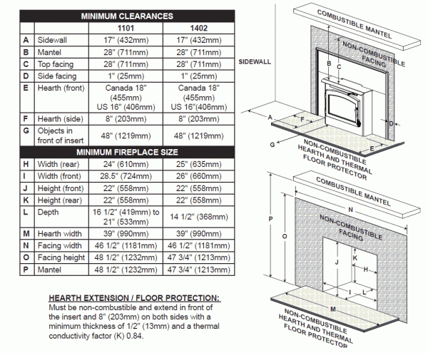

    From the 1402 manual...

    Never would have thought look in the 1402. The 1401 and 1101 manuals are combined. Thanks! So, 18", maybe I saw that diagram somewhere because I thought it was 18. I've got 15, im getting the pad for piece of mind. Thanks again.

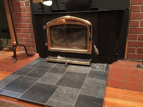

    IMG_0467.JPG So, this is what I ended up with. Doesn't look too bad, R value of 1.56 and gives me an extra 10" of protection. Thought it would be more of a pad than what it is. It's a rigid board. Went from 15" to 25" from front of stove to the wood floor. Cheap piece of mind if you ask me. Can't wait to stone the fireplace and build my raised hearth but for know this will do. Makes me feel better about the wood floor and how hot it would get. I should have got a laser thermometer and seen just how hot it was but I never did. Maybe it wasn't even close to hot enough to cause a problem but it sure felt hot with the hand thermometer.

  10. Backwoods Savage
    45,614
    285,722
    You will sleep better now. The proof of the need was in that first picture of the charred flooring.
