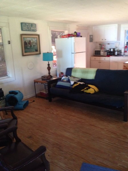

    Pictures would help immensely. Take one of your stove room, the connection inside the house and a pic of the chimney from the outside. The stove, if it’s the same one I’m seeing online, is marketed for outdoor use only with proper ventilation. I think if you had an incident with the stove, you’d have a hard time convincing an insurance adjuster to make a payment. The stove pipe is advertised as 5 sections totaling 6.5 feet and 3.375” in diameter. While that may get the exhaust to the chimney, I’d be more comfortable with a piece of pipe going all the way to the top of the chimney. I.e. not trying to tie the new pipe into the existing chimney. That diameter is going to be tough to match as it seems to be nonstandard. Would hate for this installation to cause the loss of your dream lakefront cabin.

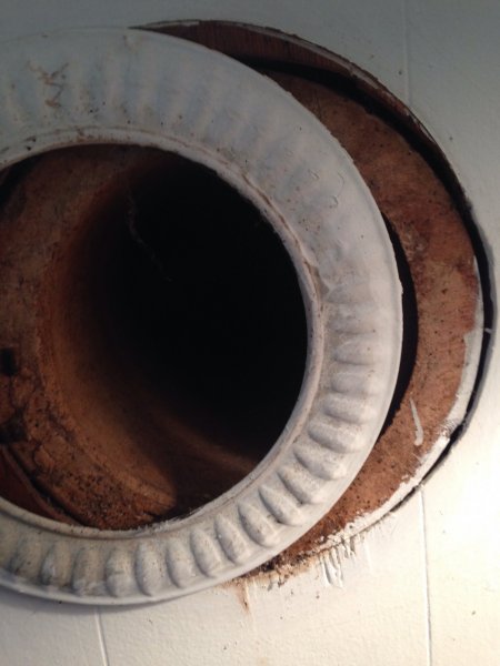

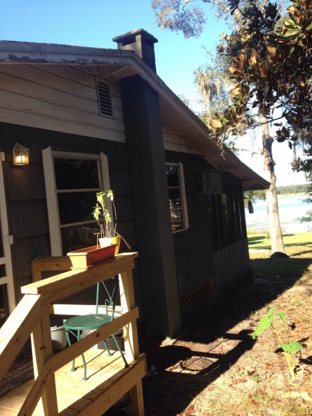

    The chimney does have a liner in it and it is the same material you see going through the wall. Looks like someone knew what they were doing when they built it, good workmanship. The concrete cap would make dropping pipe for my stove difficult. Could I not go through the wall and seal it well and be ok?

    So the first thing I see is the top cover on the chimney (that you mentioned). That would lead me to believe that the chimney hasn’t been cleaned or inspected in a while. Perhaps it was part of a home inspection when you bought but I just think it would be difficult to get a set of cleaning rods and brush in there either from the top or the bottom. I’m also not seeing a clean out for the chimney below the inlet. I believe one is required by NFPA or building code, but I could be wrong. So assuming that your chimney is clean and has a clean out, the next issue is the quality of the joints between the clay flue tiles (the chimney liner). While you don’t have the same freeze/thaw cycles that we have in the north country, the joints could be degraded which would allow flue gasses to get through the chimney and into the attic or at least to the wood siding. It would take quite a bit of burning to build up enough creosote for a chimney fire in Florida, but it could happen if maintenance was deferred for a couple years. Also the inlet clay flue is right against the wood siding inside the house.. With infrequent use, you could end up with bird or wasp nests in the chimney clogging things up. You would also need to build a hearth to protect the floor and wall. I’m guessing this stove isn’t UL certified so when it is delivered, check for a certification. Installation instructions should include clearance to combustibles. I personally don’t think I would install that stove in the house. All of the above may not be what you want to hear, but it’s just my humble opinion. Others will come along who may disagree with me...

    Thanks for the advice. I assume they had a propane heater here at one time. There is a line sticking out near the chimney. There is not a clean out on the chimney and it is about 2" away from the siding. I want something small and just enough to knock the chill out of the house, not something I would load up for the night. What I can see looking through the hole the joints are in good condition. I guess I could go propane but what fun is that? Since no cleanout does that mean I couldn't use it?
