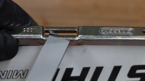

    What don’t you like about what he is doing to the depth gauge? Removing too much? Squaring it? The Oregon tool?
  11. Nixon
    Nixon
    669
    3,018
    West Sunbury,Pa .

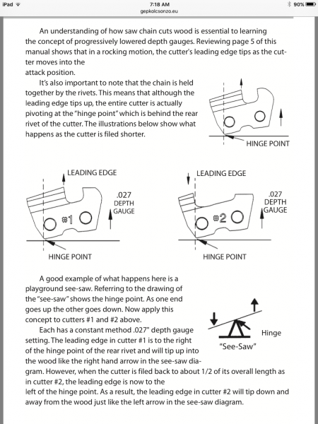

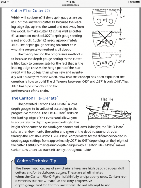

    I’ll hazard a guess . He’s just doing the standard “ .025 depth gauge setting fits all “ ,file job .
    Using a progressive gauge will give better results . Especially as the cutter gets filed back a bit . I post this from time to time ,as it is helpful .
    http://gepkolcsonzo.eu/wp-content/uploads/2012/01/complete-book.pdf
    This will explain it a lot better than I can . Lots of other good stuff in there as well
  12. The Wood Wolverine
    18,007
    114,635
    Nixon summed it up. If you're interested enough to learn how the chain does its cutting, read that file he shared. It's very informative, especially the part about the depth gauges. Progressive style is best in my eyes.
