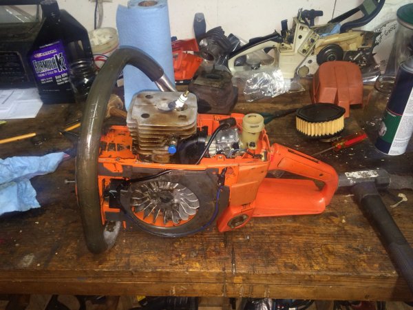

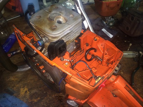

    mdavlee was kind enough to send a 394xp my way for a reasonable price. I was everything he described so I have been having fun cleaning and disassembling the saw in preparation for new parts.
    The piston needed replacing awhile ago. But the jug looks good and the bottom end seems solid. Good thing because I have plans for it.

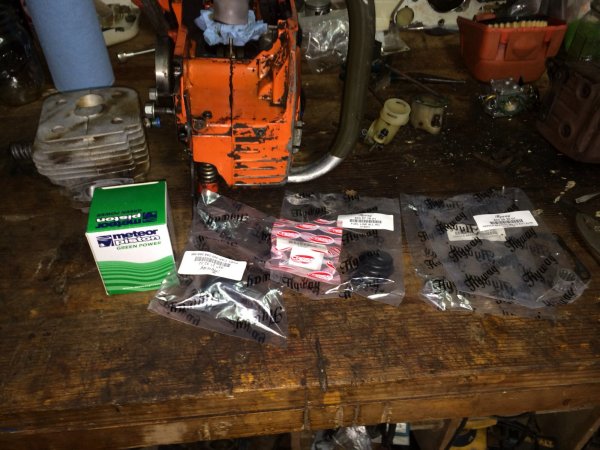

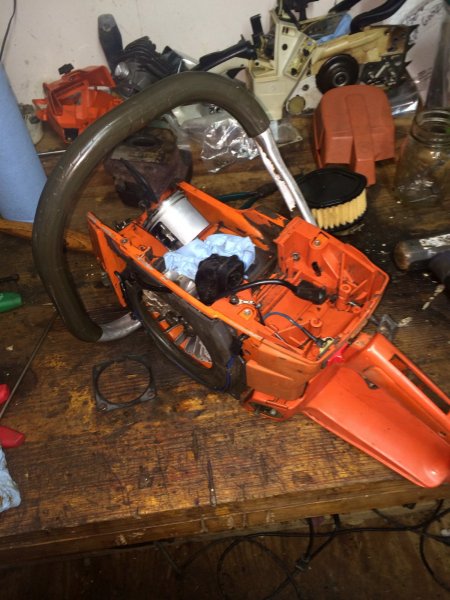

    Got parts in for the 394.
    And got the saw put back together.
    I checked the squish on the new piston and it was .028 without the base gasket. So I went with it and left it out.
    Trying to decide how to do the muffler mod. On it so as little exhaust as possible is blowing back at me. Any input is welcome.
