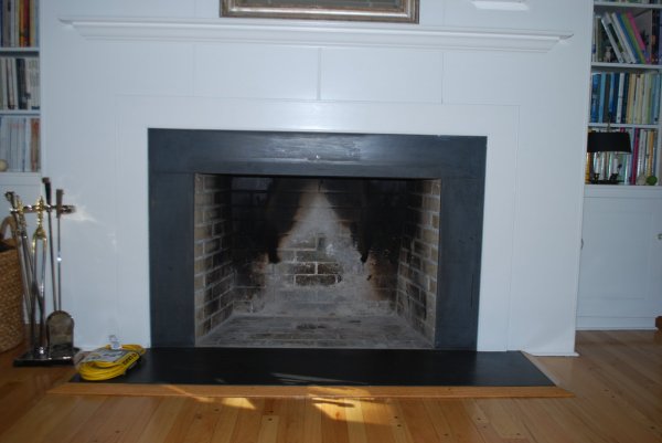

    I will be extending my fireplace hearth to accommodate a Woodstock Progress Hybrid later this year. Based on my fireplace opening height of only 30” I will need to get the short leg kit.
    My question is around heat loss.
    Will I lose much heat if the stove is placed on the hearth with the rear legs just outside the fireplace opening? Will be installing a block of plate and get the rear heat shield but want to ensure I don’t lose a lot of heat to the fireplace. Trying to maximize heat into room but minimize to a degree the stove footprint into the room (input from wife - happy wife happy life)

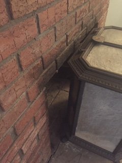

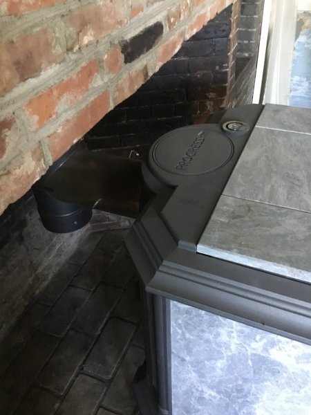

    I have a similar set up as Flamested. I stuffed rock wool insulation where the fireplace damper was and I also stuffed some at the top of the chimney to create a dead air space to keep the liner hot all the way up. I've been running this set up for 3 winters and it works fine.
    I wanted to originally put in an Ideal Steel but my raised hearth wouldn't fit it so I ended up buying a Fireview 201 that just fit. I would love to redo the hearth to accommodate a PH. I don't think I could go back to an all metal stove after running a soapstone stove.
    Keep us updated on your remodel.

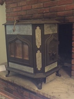

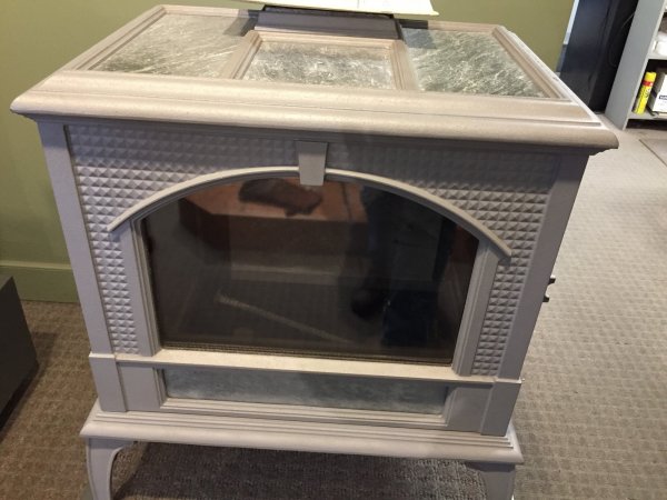

    Funny, my wife walked in and exclaimed "that one" (attached pic) as we passed the keystone. I said, no we need the bigger brother PH which is just as handsome.
    I currently have a Jotul c550 insert so I am pretty good at dealing with ash, but the little guy is just under powered and the fan noise is annoying.
    The primary goal is more heat and less loading. Based on my reading on this site (and others) the PH is a heating monster.

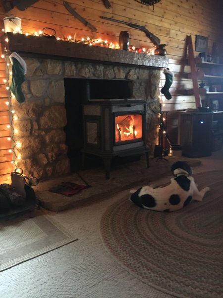

    My PH sits in front of the fireplace opening. I keep a small metal fan in the space behind the stove pointed upward to circulate air. It would work fine without the fan but it makes me feel better.
    If you want an ash pan then you might reconsider rebuilding your hearth. Your stove will last a lifetime, get the one you want. If it’s not a priority to you then carry on. Your going to love the PH.
