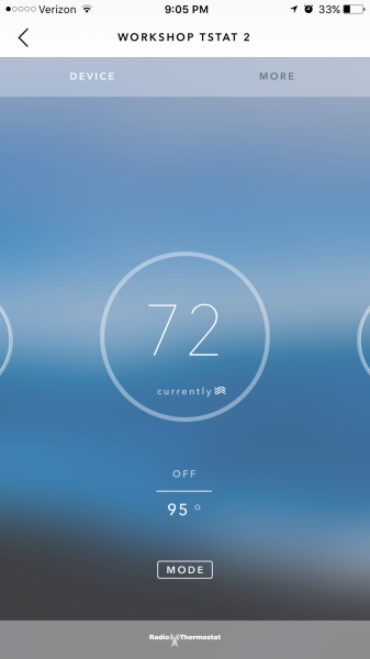

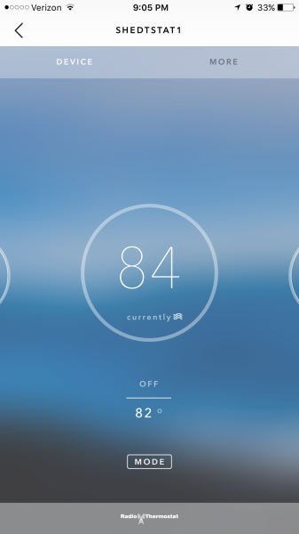

    The newer Quad T-Stats have more than just 2 wires so they can display info fed back from the Stove (called Data Controllers) they can display important messages like "Hopper is Low on Pellets" but that only works if the Hopper pellet sensor is clean and in good working order! If you have only 2 wires for the T-Stat then a generic Sky-Tech wireless will work. However why have a wireless remote that is expensive to replace and feed Alkaline batteries when you can hook up a Smartphone by downloading the free app?
    Pics below shows Quad T-Stat in Shed and Harman T-Stat in workshop on the iPhone 6 plus
    Workshop has air conditioner on right now so it is quite a bit cooler than the shed!
    Cannot wait to get that new iPhone App and Hub to control the air conditioners! :)

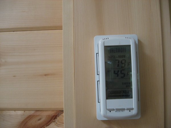

    mines a late 2015 with the newer control board,heres a pic of the stat.when i bought it,dealer told me most of the communication problems were in cities/heavy interference.....now im not so sure....i live out in the sticks,but i do have a router,tv remote,phone IMG_0574.JPG

  19. SKEETER McCLUSKEY
    SKEETER McCLUSKEY
    Aug 6, 2015
    12,211
    60,250
    Taconic Range
    sorry don,im not following.....mines wireless,i dont have any wires
