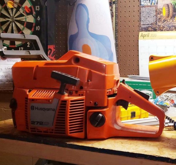

    Find yourself a good 272xp . Won't weigh much more than the saw you got but will be a lot more power . Mine has been with me since 1997 , bought it new and has hardly cost anything but gas and oil to run it . Carb clean twice and a couple of plugs is all it has needed in 23 years . Mine wears a 20" or 24" Husqvarna bar and 3/8 .050 Stihl RS on the 20" and m 3/8 .050 skip on the 24" .
