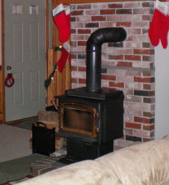

    Our furnace budget was $2000 but I can sell our Jotul F50 now and get closer to $3500 to buy a stove assuming I can sell the well loved Jotul before winter.
