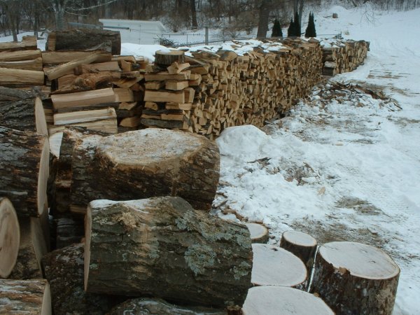

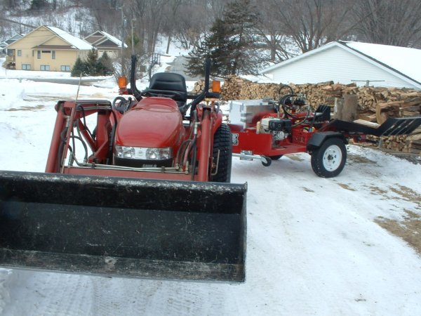

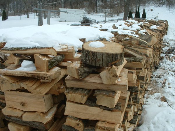

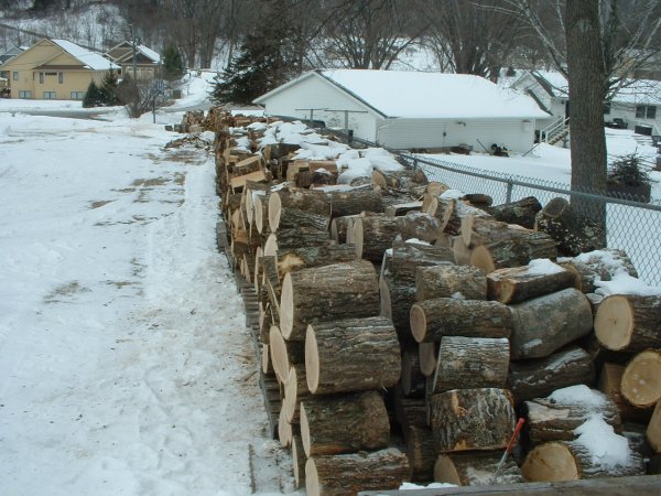

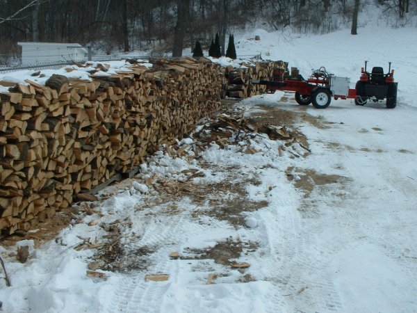

    Every year I cut as much as I can before deep snow shuts me down. Well the time has pretty much arrived now. Got a pretty fair amount.

    Looks like a fair amount of work you got done. Plus, all the rounds that you have stacked and ready for splitting when that time comes back around.

    Are you going to continue splitting and stacking even though you are done cutting? Looks like you do a good job of keeping the processing area free of deep snow.. edit. Your title answers my question. Good work!!

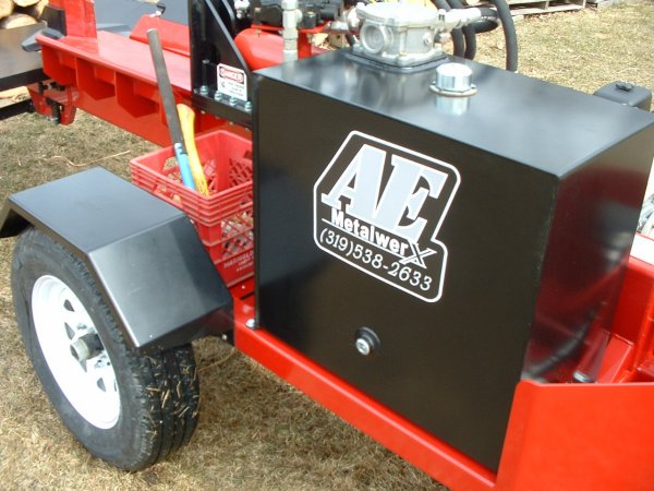

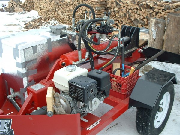

    ....did you cover your splitter hydraulic tank with foam insulation?
    Nice stacks!

    Well I have run into a minor issue or at least what I perceive to be an issue. My garage is 45 degrees minimum. The hydraulic tank holds 35 gallons. The pump is 22GPM and the valves are rated for 25GPM and it has a dump valve for the return stroke due to the 5" cylinder and 3.5" rod. Since the hydro system is so well designed and conservative, THE SYSTEM IS RUNNING TOO COLD! After 3 hours of running in temps of the mid 20s the tank is only up to 70 degrees. I insulated it to have it warm quicker. Now in the same temps it is still only 80 degrees after 3 hours of running.
    Colder temps aren't hurting anything but this is not optimum. The auto cycle valves and everything are working fine but the return pressure is running way higher than it should and is probably getting real close to the bypass on the assembly at 25PSI.
    Anybody ever heard of a splitter running too cold?

    My hydraulic system has never run too cold but I do notice that before it gets heat into the detent on the return stroke sometimes pops out until it gets hot. Next time I am splitting in the cold I am going to shoot it with a heat gun to see some actual tempatures.

    I've heard of other people's running too cold, I think they put a stick on heater on the tank to pre-warm it.

    I've looked into that. I am not wild about a "stick on" heater. The hydro tank has a port for a heater already installed. Just need the right adapter as it think it is 3/4" and the heaters are 1/2" at 750 Watts. Like I said though, it is not super cold as the garage is 45 degrees in the Winter.

    Does it require a 35 gallon tank? Could you drop to 20?

    Oh wow, did not know anyone installed heater ports for them!
    Throw a glow plug in there and it should warm right up!

    The builder suggested taking some fluid out but that sure seems like a hassle. Besides in the grand scheme of problems, this one isn't a real bad one. Although you are correct, less fluid would run hotter.
