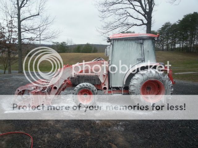

    Screwloose
    Jan 15, 2017
    4,849
    27,832
    Distance is the key with a pressure washer. Couple feet away you can rinse your hands close up can cause damage. What I do recommend however is greasing every electrical connection you can find with a ELECTRICAL grease. I use nyk 77 (I think). Disconnect and clean up the contact points FILL the connection and reconnect then wipe off what extrudes and place in the next prepped connector. Do this even on the light sockets.
    My second tip is to go and buy a decent pump up garden sprayer or 2. Fill one with a good car washing detergent and the other with a gentle degreaser.
    Third tip is a spray on while wet wax that you towel dry off works well.
    Hammy, concretegrazer, XXL and 5 others like this.
  13. 94BULLITT
    94BULLITT
    Sep 20, 2014
    2,446
    7,184
    Frederick County, VA
    Nothing is going to replace a proper hand washing. I use a pressure washer with a foam cannon and touchless car wash detergent for touch ups.

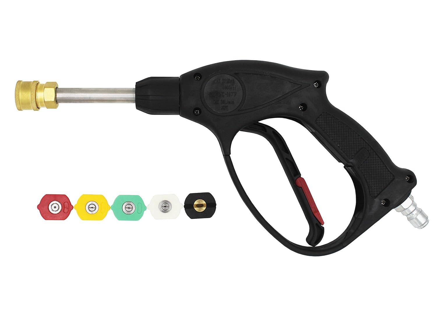

    I bought an extra handle for my pressure wash and removed the 3' wand and attached the fitting that hold the tip directly to the handle. Basically looks like this but without the 3" steel piece. Works great for getting into those hard to reach areas like wheel wells and bottom sides of things like mower decks. I end up using this handle more than the 3' wand even when washing the top side off my pickup.

    I don't have a picture of mine but the flexible one is handy.
