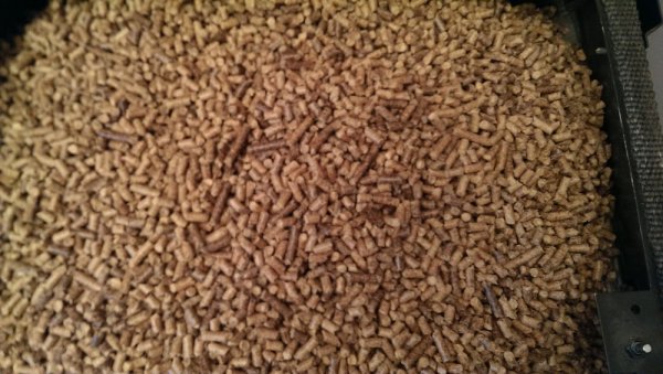

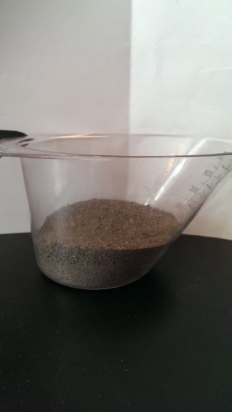

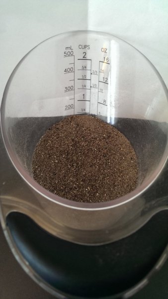

    PTL results: FINAL RESULTS
    Temp Average - 260-320 (on door thermometer)
    Ash Volume - 5.75 ounces
    Ash Weight - 1.10 ounces
    Ash Percentage - 0.17 (outstanding)
    Fines In Bag - less than 1/8 cup (was next to nothing)
    Pellet Length Avg. - 1/4" - 1.5" see pic
    Bag Weight - 40.4 lbs. (9.85 oz. left in hopper)
    Notes:
    Bought from Lowe's Bethlehem
    $230 a ton
    Almost no fines (couldn't believe it)
    Screwed up and didn't buy a ton of these!
    Well, purely based off the "look" of the pellets, I wasn't expecting anything great. There were some longer (1.5") pellets and the pellets vary in color. Boy was I wrong on that! Last years PTL's were EXCELLENT and I still have 20 bags or so leftover. This bag did not disappoint either. With the exception of my auger crunching the longer pellets once in a while these also should have been my go to this year (based on price, ash and burn). What pizzes me off is I bought the supposed "real" Ligs and they have double the ash of their "box store" brand. WTF is up with that?
    Disclaimer: as with everything.......YOUR MILEAGE MAY VARY

    Those pellets look "mixed"?
    All of mine are DARK. Like super dark!
    Great review though. As always...

    Dex....that's what I remember of PTL a couple years ago.....very dark....then last year and this year....so far.....lighter color and great burn.....

    x2, Last seasons were about the color of a light coffee-ish. Cleanest pellet I burnt last season(besides the samples I was teased with!) and nice heat too. 25 bags still in the stash and wishing I could find some more for this season.

    Yes Jay....my last seasons pellets are a lighter color too.....
