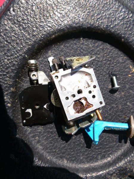

    I found the problem!!. When i went in for the carb rebuild, there was so much saw dust on the screen in the carb i could not even see itDo these things normally have a fuel filter on them? IMG_20140408_120832_649.jpg

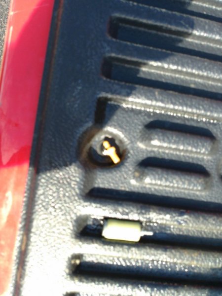

    Poured out the tank and look what I found.
    What is the plastic fitting for? The tiny fuel line didnt go over the filter end well but I squeezed it on. Still dont know where that adapter goes? Thought that it went on the small line then a larger hose on the big end then to fuel filter but that makes no sense as the small end and filter are same size IMG_20140408_162005_730.jpg
  20. BillinTX
    BillinTX
    Oct 9, 2013
    81
    317
    Northeast TX
    The small fitting goes on the end of the return line.
    It's just to keep the line from pulling out of the tank.
    clemsonfor likes this.
