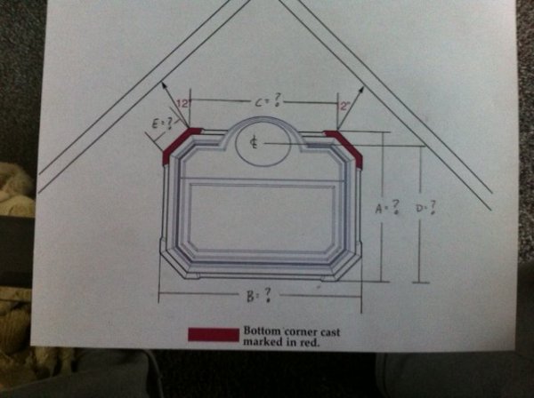

    We're thinking about upgrading and wanted to see how the PH will sit on the hearth. Can anyone help me with these dimensions? I'm looking for the dimensions of the bottom cast.

    Per manual for the PH:
    Corner installation with rear heat shield on stove: From stove base corner (nearest red marking to wall on your diagram):12inches (determines placement)
    Pipe to side walls =6 inches (UL Listed close clearance pipe)
    Pipe to corner point directly behind stove +6 inches (UL listed close clearance pipe)
    These are clearances with back vent. They don't list clearances for top vent, but it would be the same, because that side wall measurement determines placement.
    Depth 25 inches
    Width 31 inches
    Corner hearth pad:
    Minimum hearth pad with a corner installation must be 54 inches x 54 inches (with the front corner cut off).
    Calculating a corner hearth pad per NFPA211:
    A=C x 1.414 + W/2 + D +Front Hearth requirement
    A= distance from corner to front of hearth pad
    C= Clearance from rear corner of appliance to wall (12 " with rear heat shield)
    1.414 is a constant
    W/2 = half the appliance width (15.25")
    D = Appliance depth (25")
    Front hearth clearance =12 " (this can be reduced is necessary by adding the ash lip, I think to 8 inches)
    A=12 x 1.414 +15.25 +25 +12 = 69.25 inches
  4. Flamestead
    Flamestead
    Dec 7, 2013
    2,160
    10,926
    Windsor County, VT
    A 23"
    B 30"
    C 23"
    D 19"
    E 5.5"

    Flamestead- is the number for "D" you gave me from the top cast or bottom cast. I drew the footprint per your numbers on a piece of resin paper but the outlet for the stove pipe doesn't look right when I compare it to pics of the PH. I'm trying to figure out if top venting with a straight shot to my existing ceiling box will give me the required clearances, so I need to locate the center of the pipe outlet. Can you give me from center of stove top to center of pipe opening? Sorry to be a pain in the rear...and thank you for your help!
  7. Machria
    Machria
    2,426
    4,983
    Long Island, NY

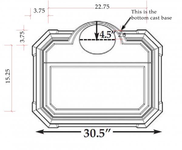

    "D" would be the cast at the top. "A" is the cast at the bottom of the stove, which sticks out a bit further. Use A (cast at the bottom of stove) to set your 12" from back corners. Mine is corner located, and I'm at 12 1/2" from either back corner. If I had the space, I would move it to 13 or 14" from the back corners. My slate tile off those back corners gets pretty hot. The slate I used is a dark metallic grey, which picks up and holds heat because of it's color and metallic properties.
    Anyway, this drawing should help. Woodstock sent me this prior to my install:

    Based on Machria's post it looks like I was off a bit - the stove was rather warm and I tried measuring with yardsticks - hope it didn't throw you off too much. 19" from the center of the top vent to the top front casting is pretty close.
