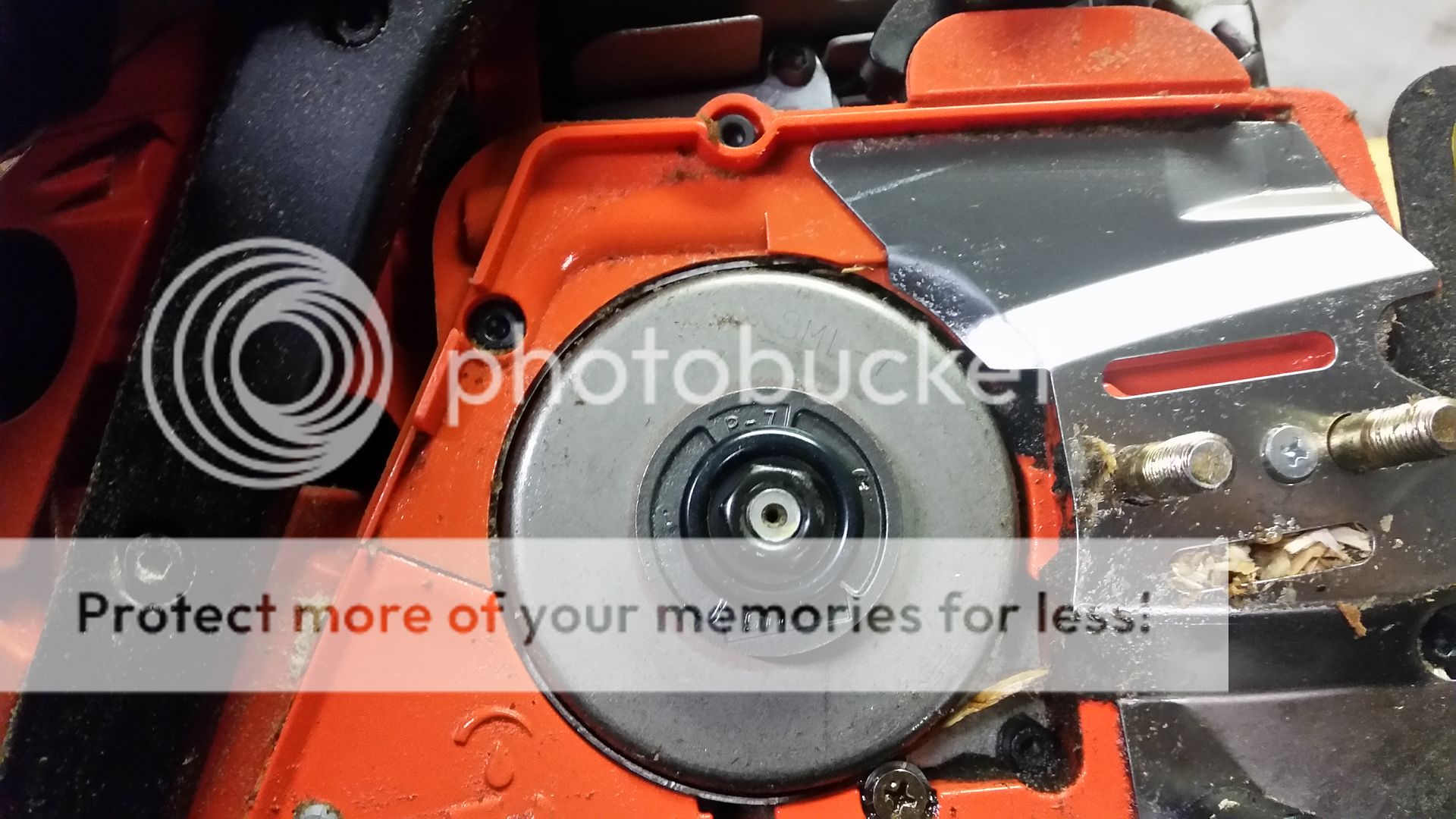

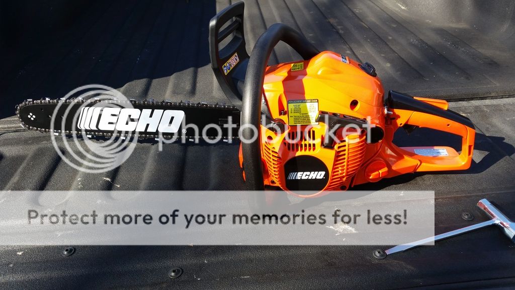

    300$ with 18" .325 bar, chain. One of the lightest 50cc saws around, even come with a small spline rim setup.[​IMG]

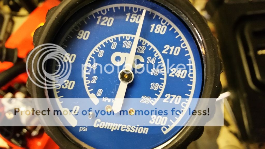

    Decent comp for a stock saw.[​IMG]

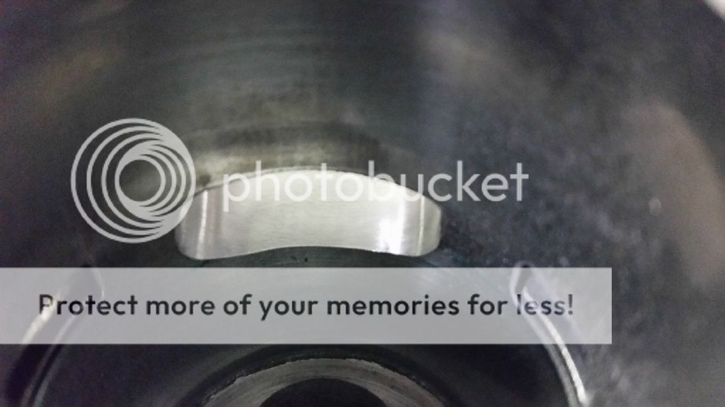

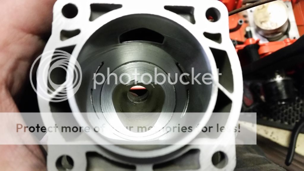

    Intake 71/82 (comes to a point at the bottom, exhaust 114 transfers 125.
    Cut .053 off the base. # 88 intake 121 exhaust 131 transfers.

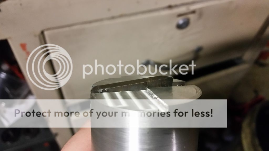

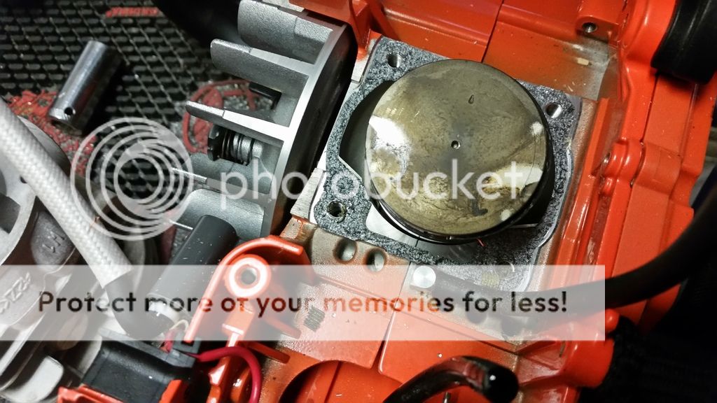

    Piston has a 7* dome, so I cut the squishband parallel. If using a madrel make sure the cutter isn't too long...[​IMG]
    Squish set at .018
    Marks by the plug is from my dumazz attack. Leaving the tool bit too long...
    Set exhaust at 106, worried it would break through the roof...
    Transfers set at 125, yes it has removable covers, but wanted the practice with the rt angle hand piece.

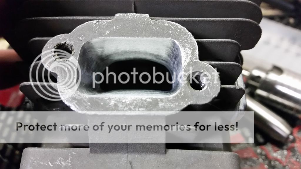

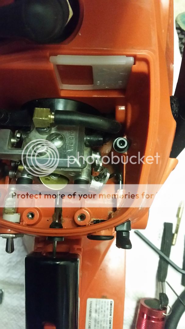

    Roughed up the intake, widening it and raising it back to stock location.[​IMG]
    Glueed the jug on via permatex 51813.

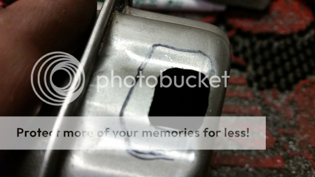

    Added a second muffler port.
    Sporting one of my new medium deflectors :D

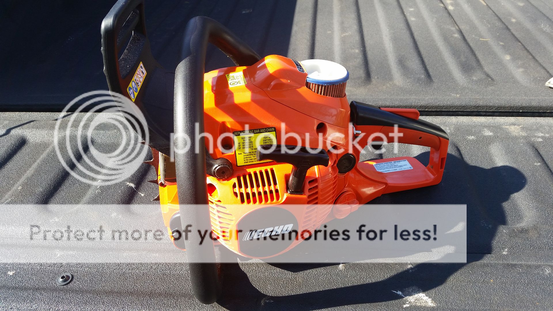

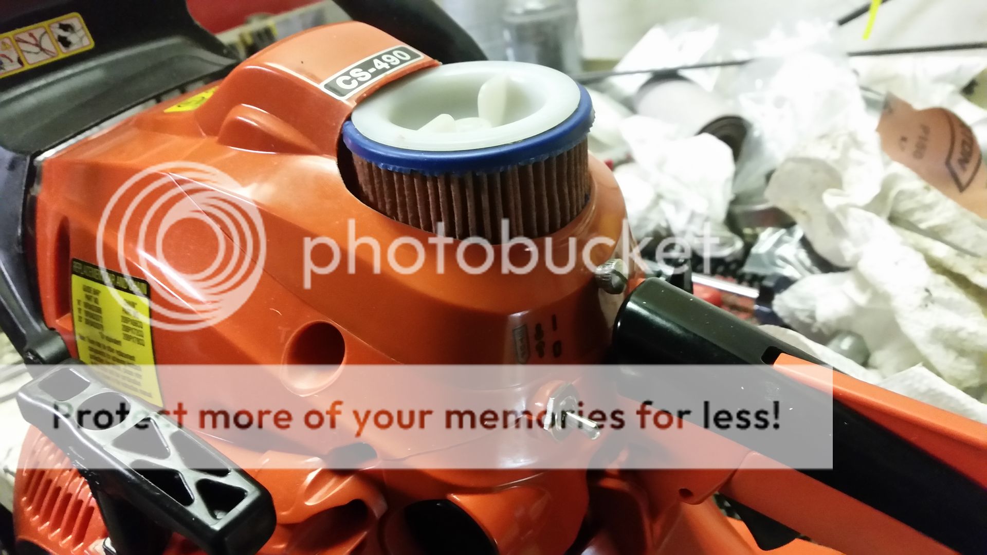

    Modified the air filter setup. Kind of a hot rod look lol.
    Set at 12,900
    3/8×7 16"

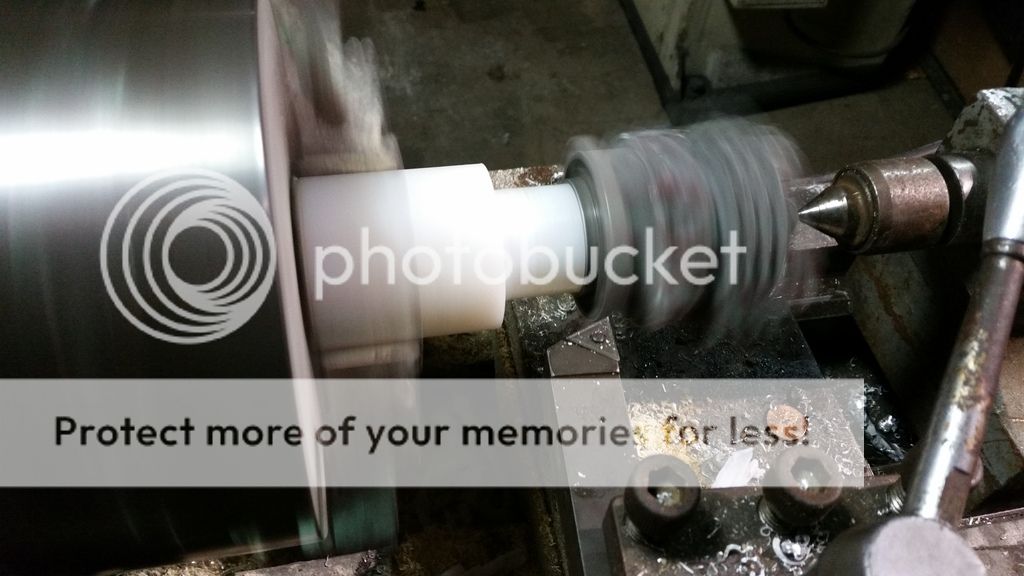

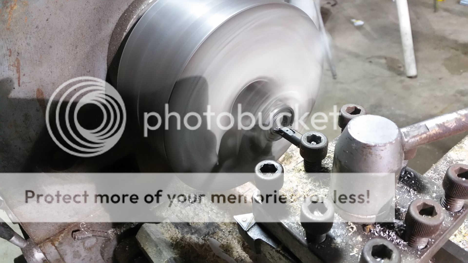

    Modified a Picco rim to fit this thing.

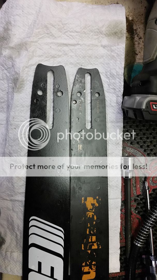

    Added some oil holes to a 18" lo pro poulan bar
    Same log as all the other clips.

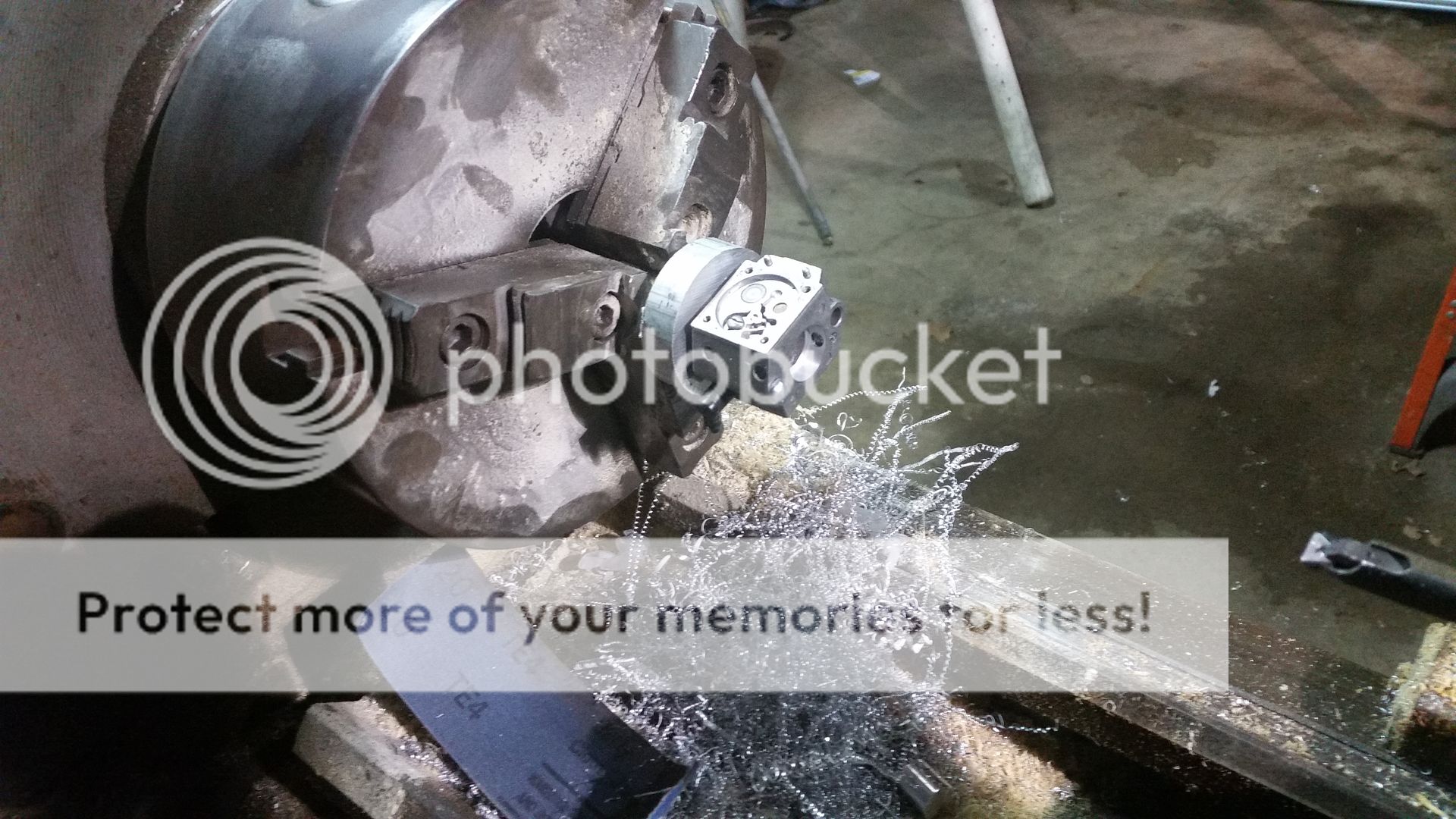

    I sure am liking the 3 jaw chuck for these type of things.
    Boring the picco rim out. Just cut the splines with a small burr. Little bit at a time until I got the fit I wanted.

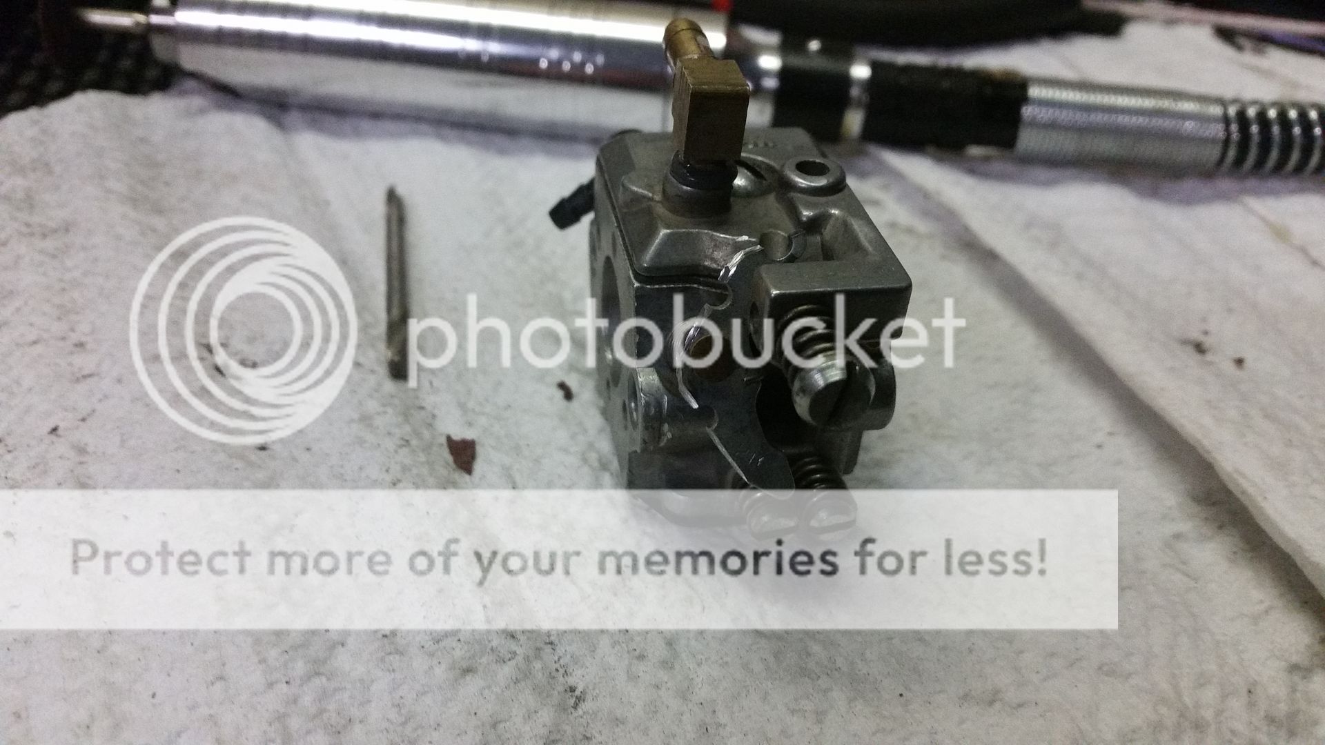

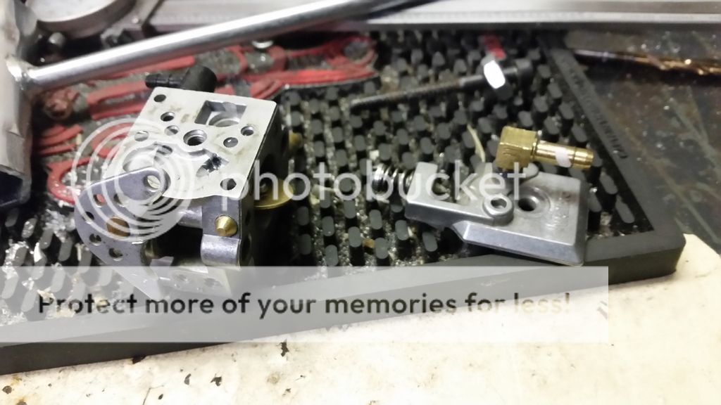

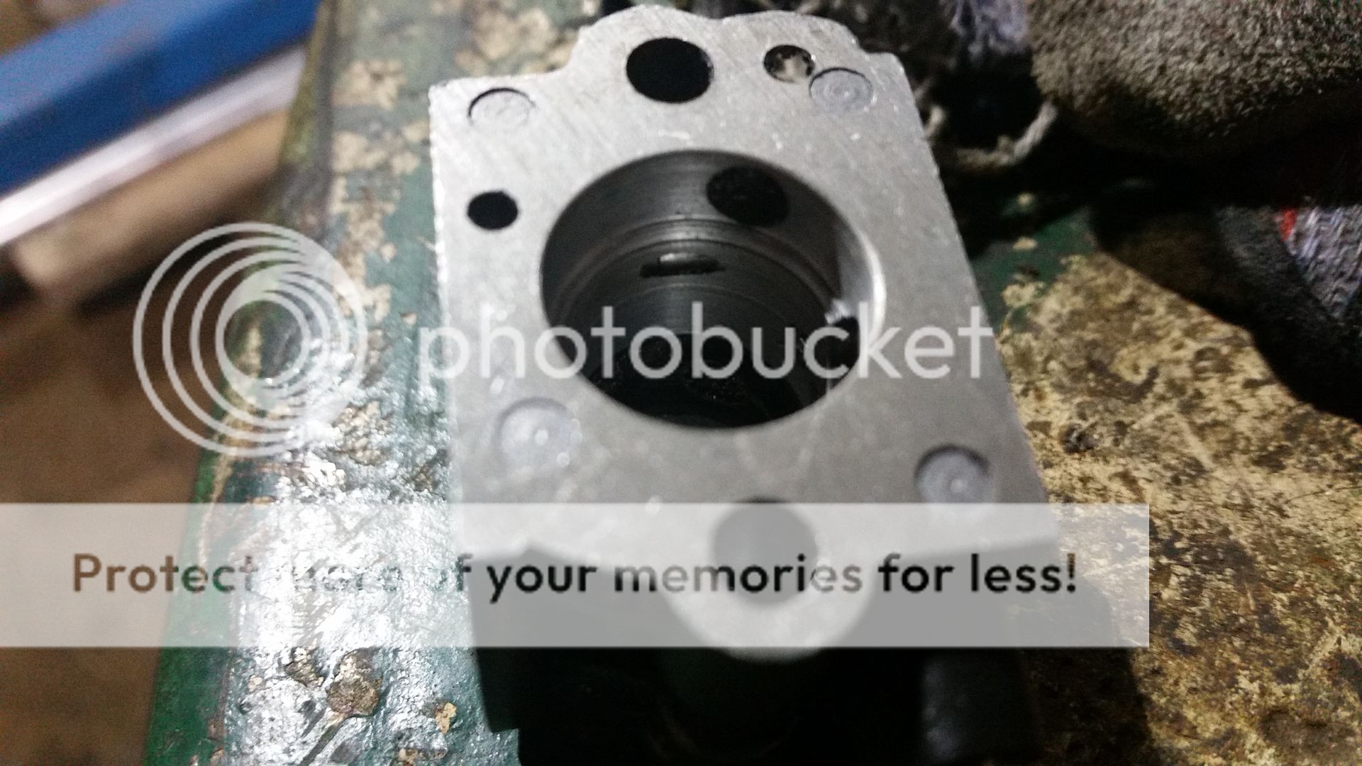

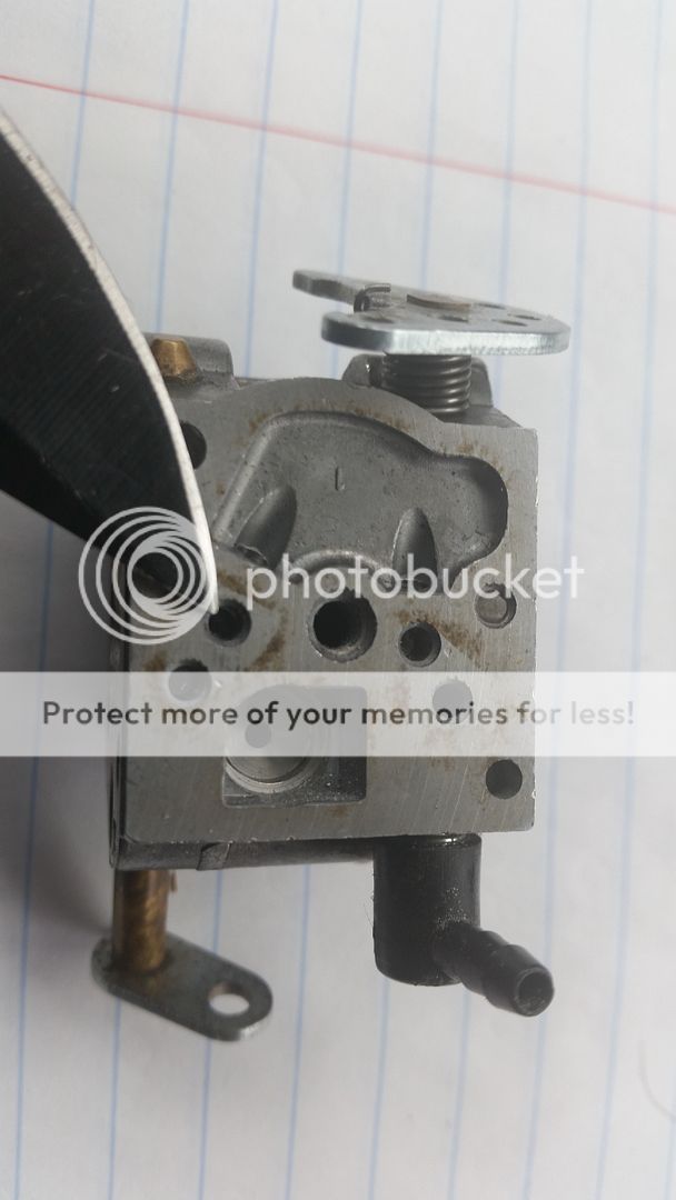

    Started on some carb mods....

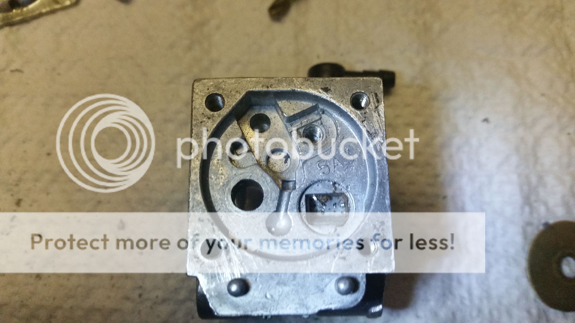

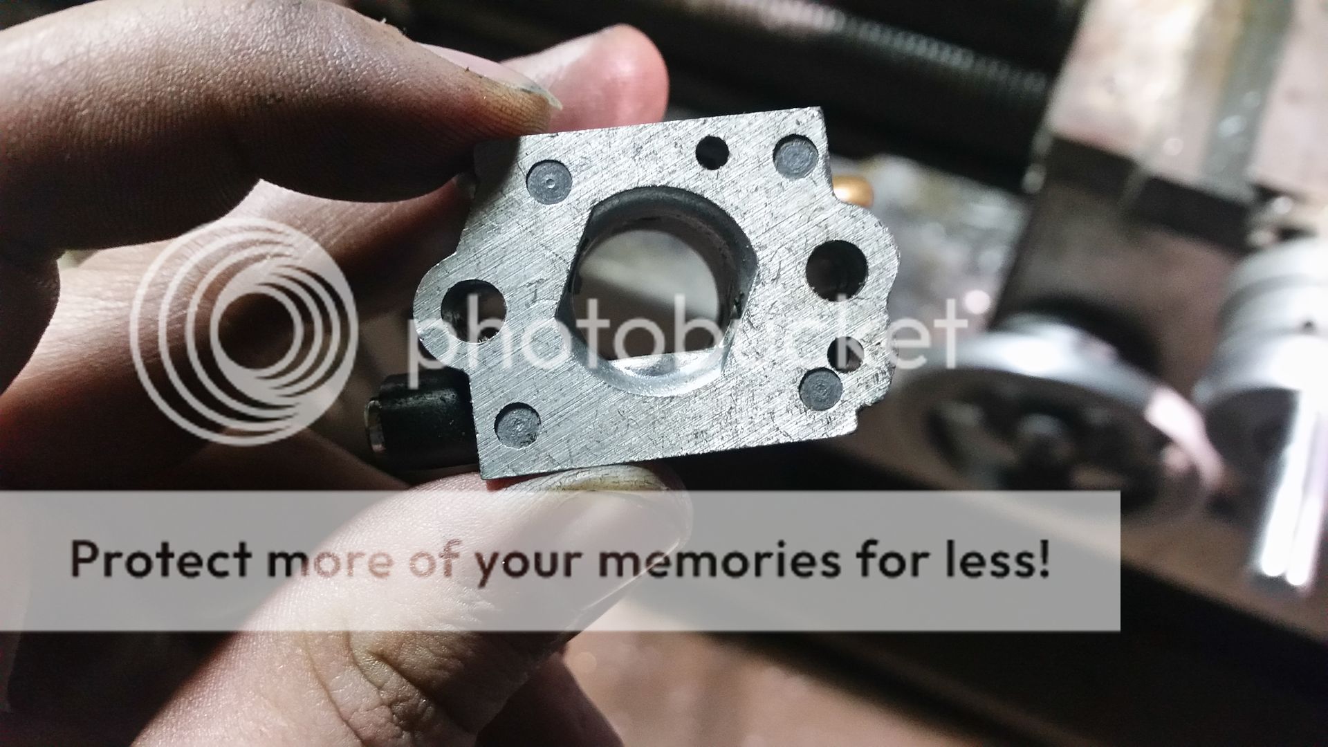

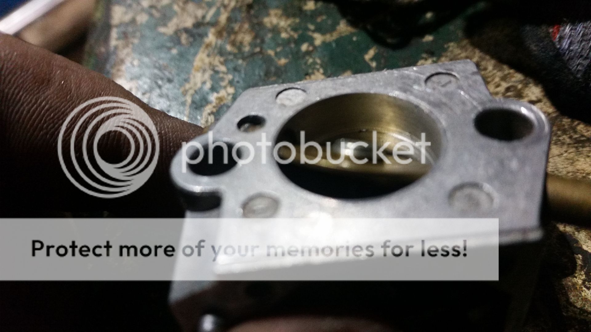

    Venturi opened from 14.25 to 15.6, stock carb has 13.5. Choke bore opened from 16mm, to 18mm same as stock.

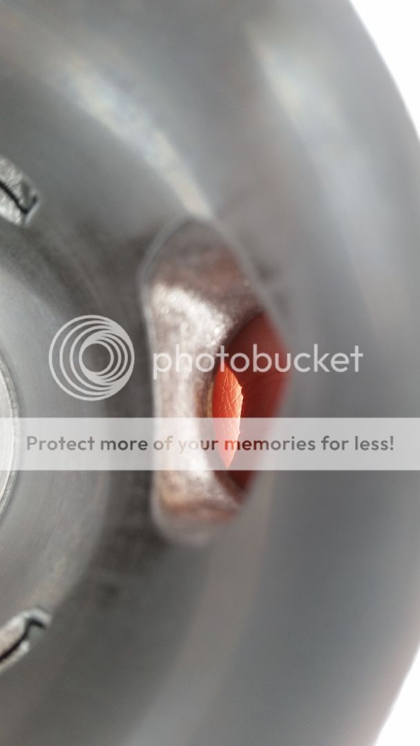

    Got into a passage trying to blend into the venturi, just a lil pin hole...[​IMG]
    This one to be exact. Going to fill it with jb, and redrill it.

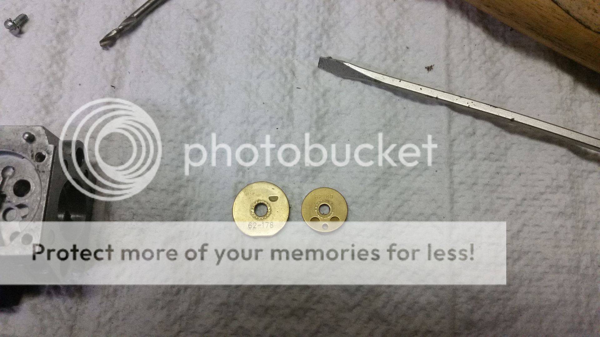

    My zama option was an absolute disaster... tiny choke opening stock but listed as a 14.6 venturi.
    Tryed opening the choke to 18mm, same as a c3el32. And venturi to 15mm
    That is the needle visible lol and a couple other passages in the venturi. Not a viable performance option.

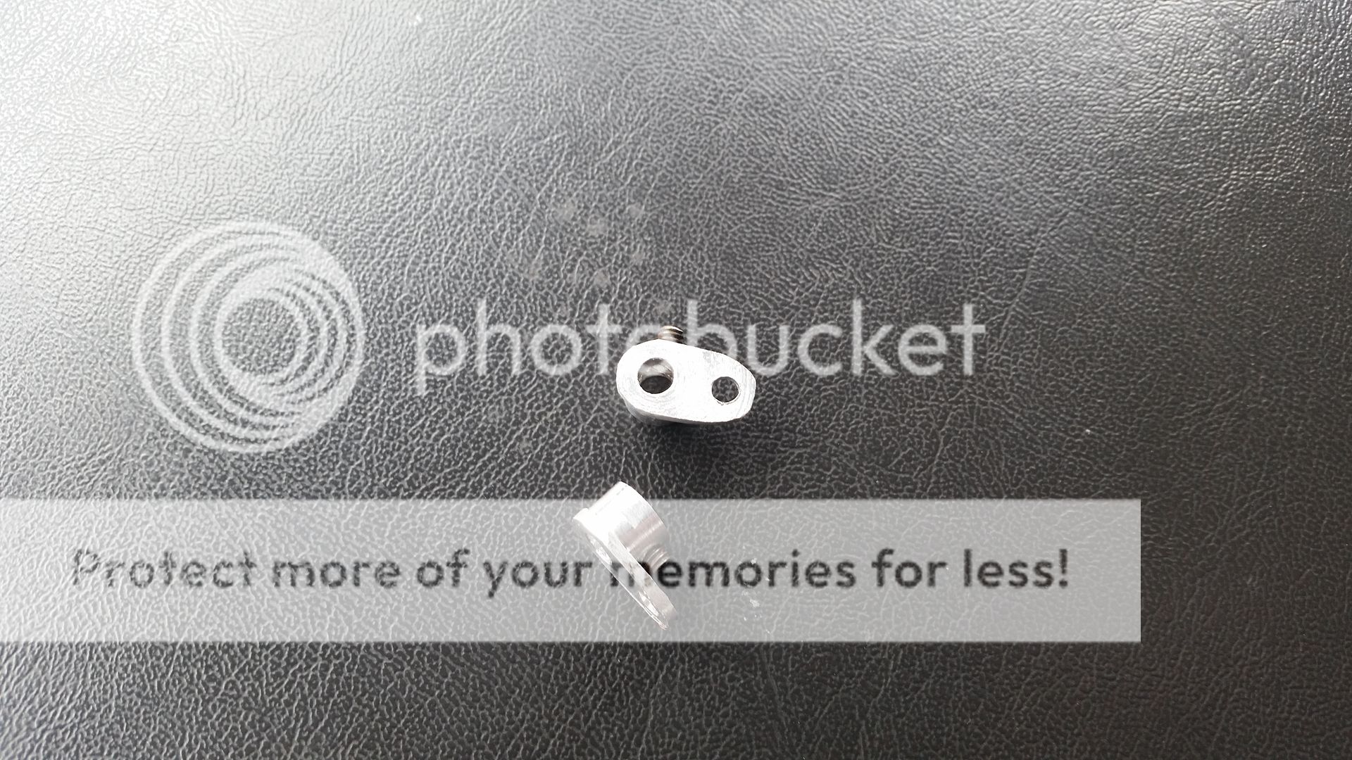

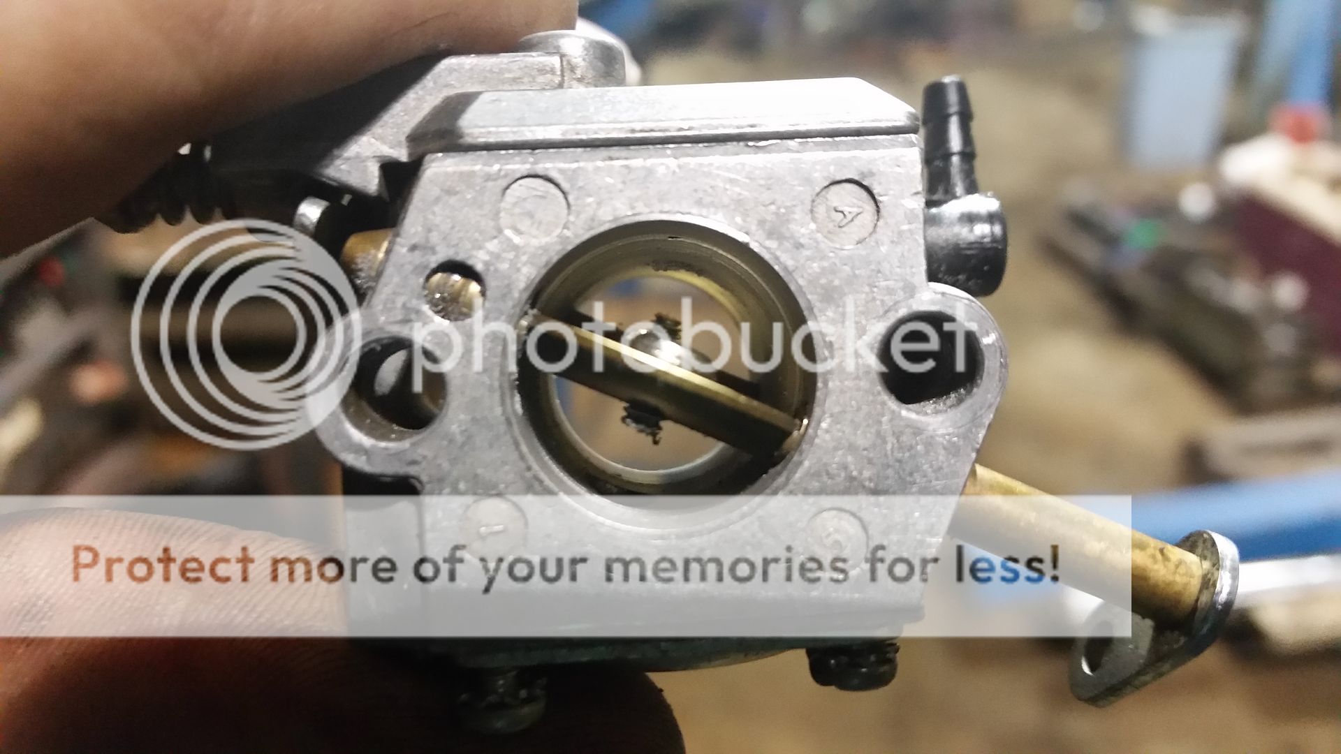

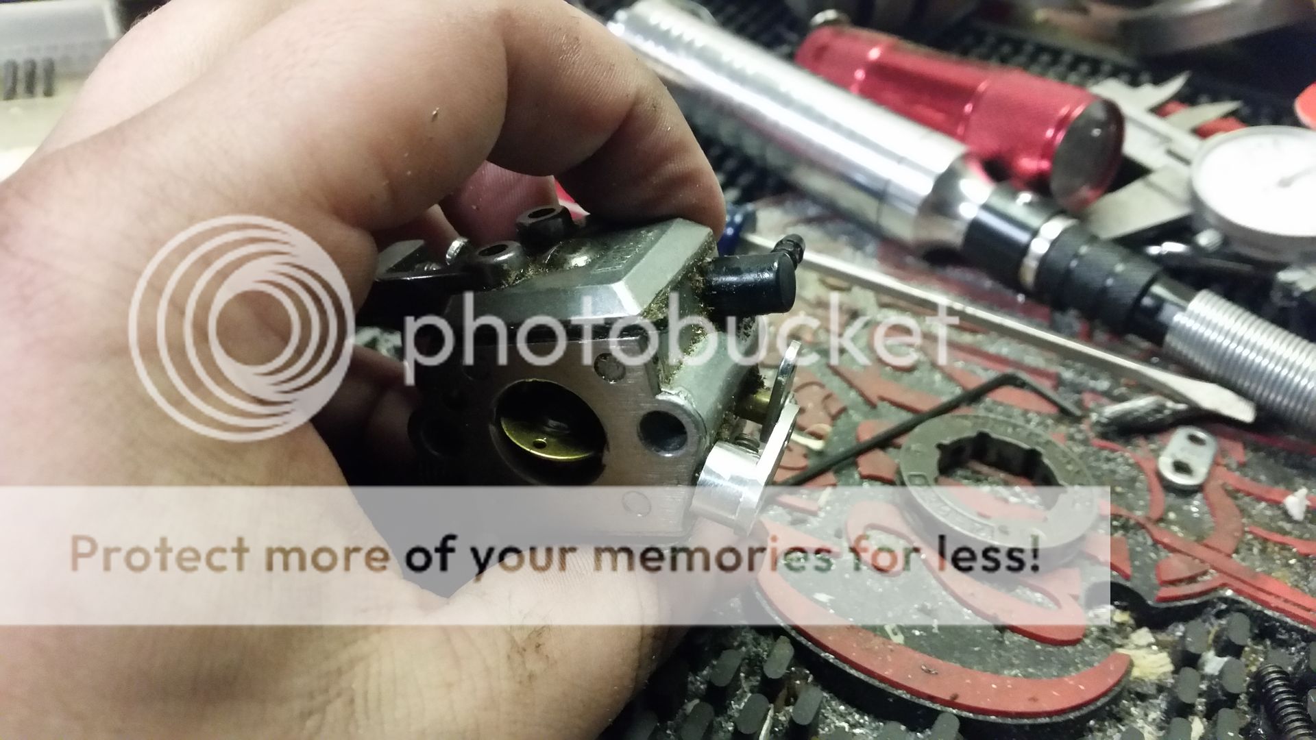

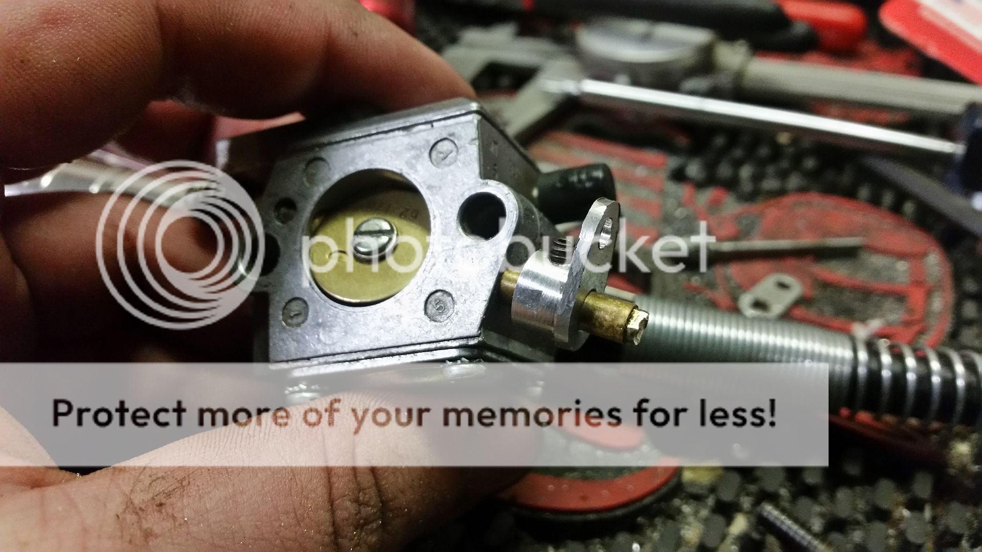

    Made these gizmos for the choke linkage.
    These carbs have a long choke rod, with the plate peened into position.[​IMG]
    Something like this.

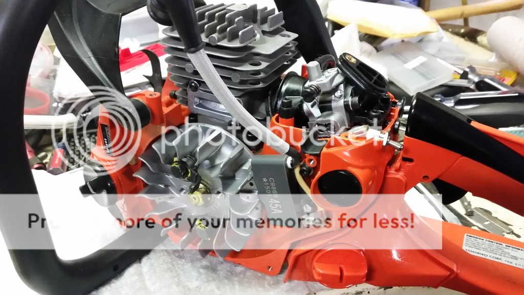

    Moved the impulse to the top cover, filled my oops hole and the old impulse with jb weld.
    Really hoping this new coil will gI've me an extra 1000-1500 rpm.

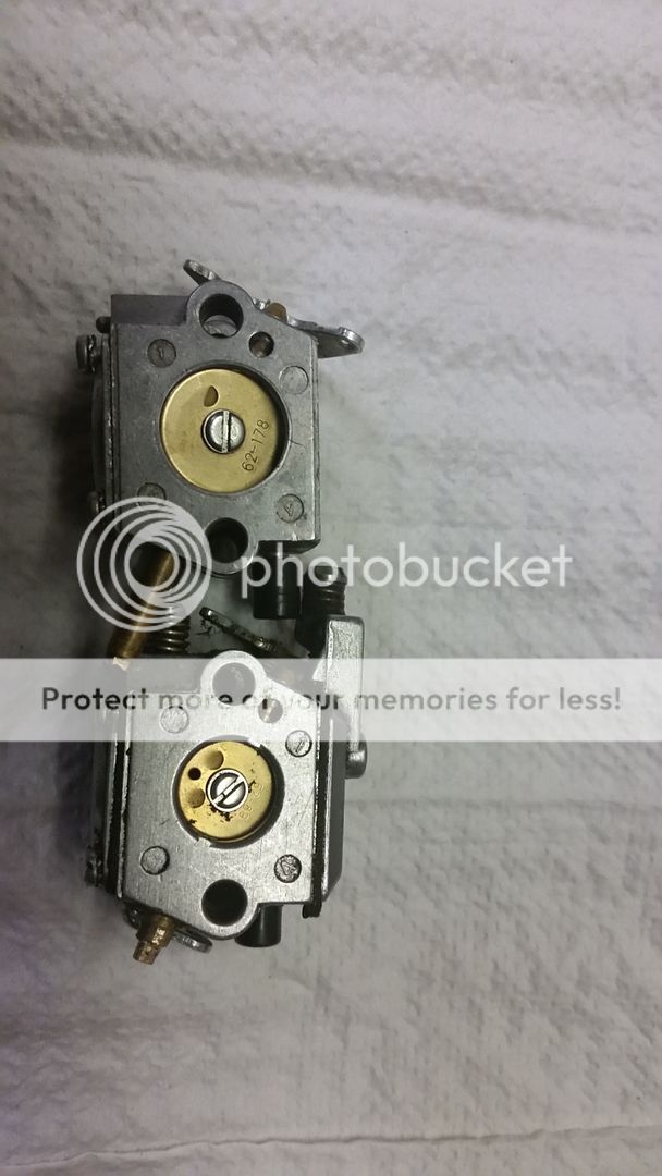

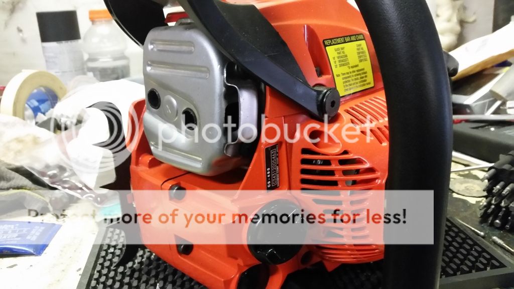

    Better pic of how I mounted the a/f cover.

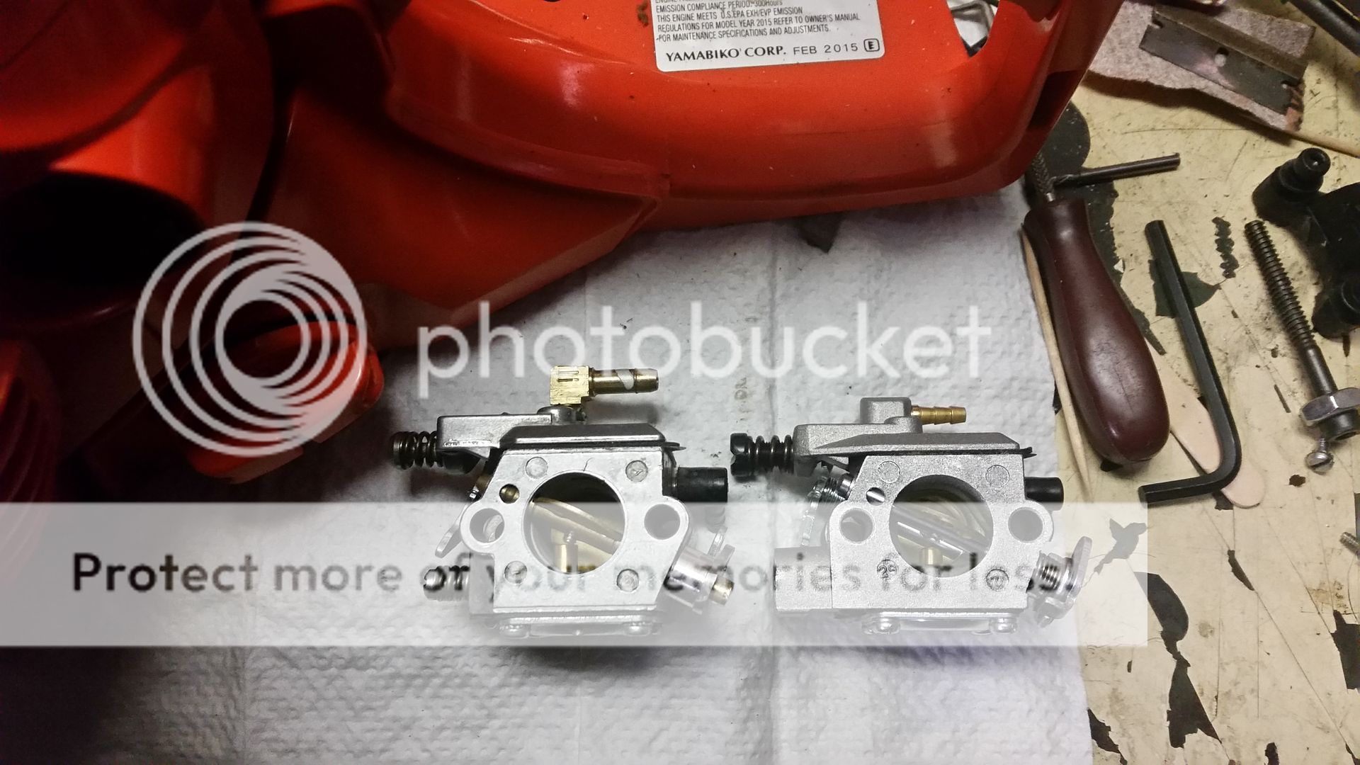

    Carb on the left is the one I opened up.
    Old and new choke plate.
    Stock echo carb on the right. Modified on the left.
