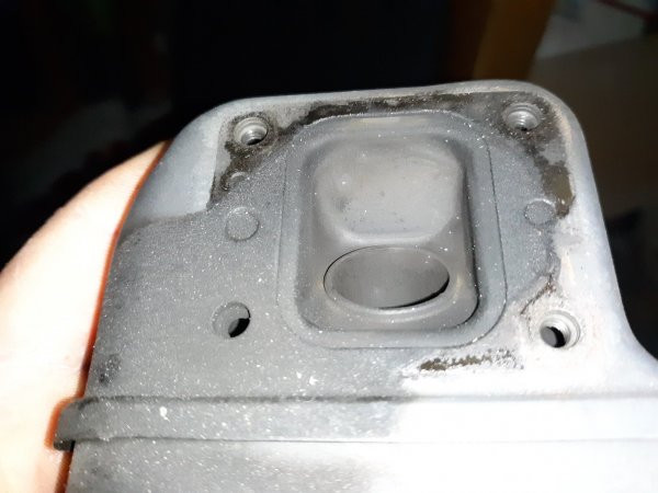

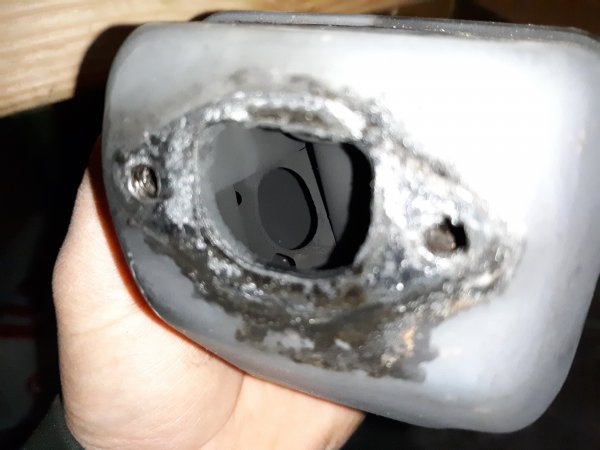

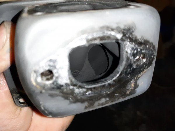

    20220113_170736.jpg 20220113_170742.jpg I told the guy that ported my 590 I didnt want it obnoxiously loud. All he did was open the internal baffles and left the rest alone. 20220113_170921.jpg theres big gains to be had by just cutting the spot behind the tube. Would basically be a straight shot from the exhaust port to the deflector. There ears bleeding through hearing protection loud done like that though.
    Tell your porter what you want from the saw I'm sure most will work with you.
