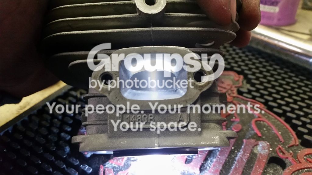

    Raised the ex up a bit past stock.
    Ex finished
    Squared and raised the intake.

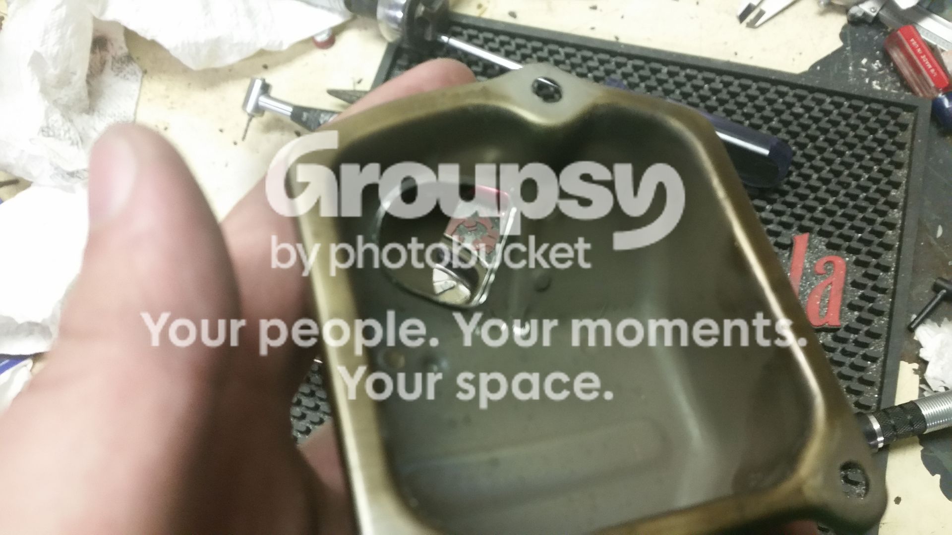

    Just took the gills out of the muffler and opened the stock deflector a bit.
