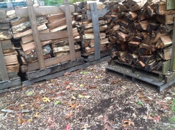

    I've been using wood racks since I got my tractor. Used to make then collapsible but that wasn't worth the extra work. I use only oak pallets and take some apart for materials to make the upright sides. I use unwoven chainlink wire that I straighten out across the top of uprights, to keep the sides from spreading.
    ALWAYS USE SACRIFICIAL PALLETS UNDERNEATH.
    These do rot and I don't care if they are softwood.
    I've only had a couple of the firewood pallets rot out over the last 8 years. I have damaged some with my forks when I'm rushing to move them around.
    I can lift a 42" full pallet of green red oak only a foot off the ground.
    Same pallet after 3 years is so much lighter!
    If I want to stack 2 pallets high I make a pallet shorter in height.
    I can easily move, in a few minutes, a yard full of pallets to reorganize after a year of burning.
    These pallets only cost me the time to make em. I use epoxy deck screws or galvanized ringshank nails from a nailgun when building. Both work well.
    Keep in mind this is is only with oak pallets they both pull out easily in softwood pallets.
    I'm lucky to have a source of pallets around the corner from me.
