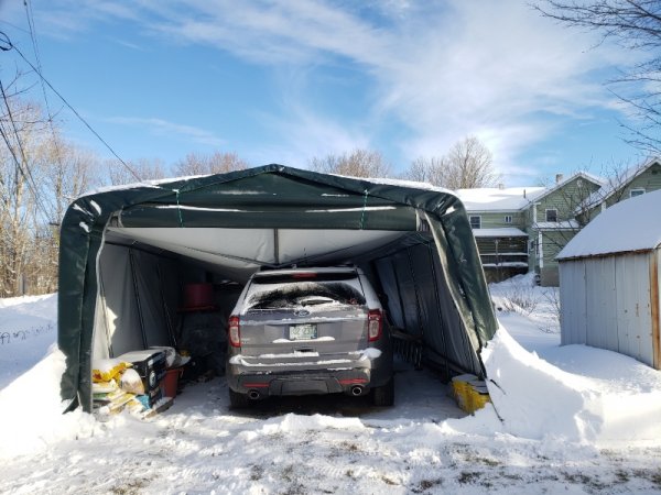

  12. bogieb
    11,953
    72,360
    That was a 14x20x12T tent garage and they have been discontinued and have gone to 15x20. But you can get them custom sizes from what I've seen.
    To be fair, I had the tent that collapsed set up in a high wind area. Even with cables shot into the ground (versus the screws they normally come with), that sucker got moved back about a foot by the wind - jumping rebar that was sticking up 12" above the rail to prevent that very thing. If you get the 2-1/4" pipe, they are a lot stronger than the one I had. OTOH, the heavy duty fabric (not the standard fabric) is tough as nails and is still keeping the sides of the structure up (besides the ton of pellets in the back corner that you can see in the 2nd picture).
    I looked into a metal carport combo 20x24 building and pouring a pad (to replace not only the tent but my 8x10 shed). By the time I got done counting up the heavier steel and added supports (every 4' instead of every 8) for snow load, I was so close to what it would cost to put up a wood building that it wasn't funny.
    If I had a more sheltered spot to put the tent garage, I have no doubt it would still be standing - it wasn't really the snow that took it out but the weakening the supports by constant movement in the wind.
    MikeInMa, mat60, Horkn and 4 others like this.

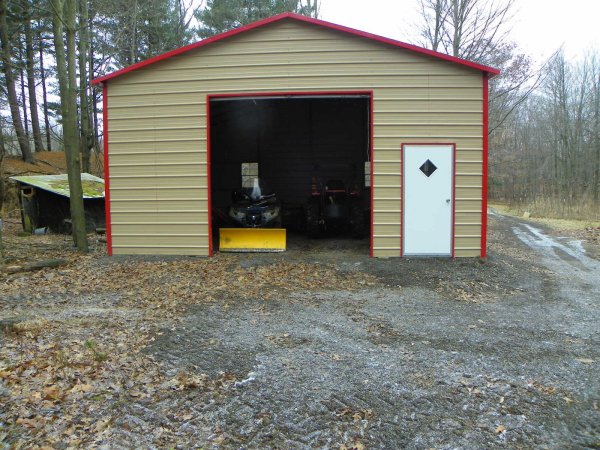

  18. Backwoods Savage
    45,560
    285,316
    Methinks you may find the cost between wood and steel may make you think more toward steel. Even if you put sides on you can always remove them, but with both ends open that should keep it cooler and really cool in winter months.
    Here are 2 steel sheds we have.
    MikeInMa, Chvymn99, bogieb and 7 others like this.
