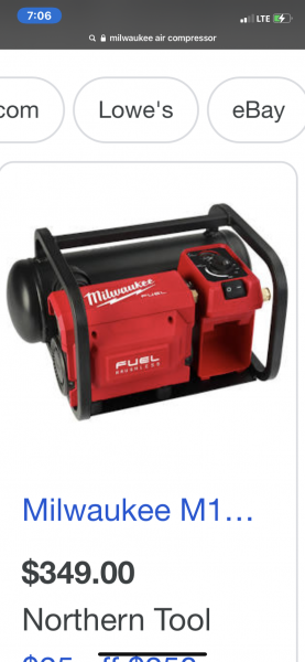

    I have lots of Milwaukee tools. This fits in my truck box and is a very nice compressor.
    Horkn, amateur cutter and eatonpcat like this.
