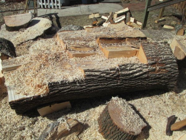

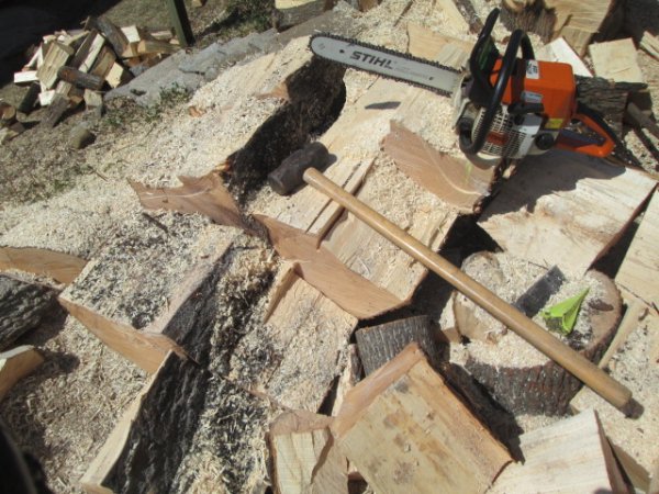

    I don't have a splitter or a large saw, so I attacked the Norway maple trunk with the 025 cross cutting down as far as I could go. I started wedging across the top. I worked in steps. The trunk was about 5 feet in length and 30" across. I am not stubborn, just persistent. It took about 3 hours off an on with an 8 lb sledge. I made the wedge mushroom a bit.:yes:
    I noodled as needed. If I had a second wedge I would have went right across. Each chunk will yield 2 or 3 splits.
    After two rows across me and the neighbor rolled it over and wedged it a little and kept going.
    I used the neighbors twist wedge when needed to free my wedge. I hit some rot right where the main leaders separated. The rot line helped it break apart. There was very little internal rot. No carpenter ants.
    Pretty much a done deal. I will begin splitting this evening as a few hours of recovery.
