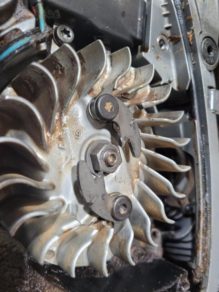

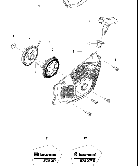

    I got into the recoil last night and I think I'm missing a couple of pieces out of it when it let loose. On the top picture, you can see where the recoil assy housing broke where the threaded bosses are. There was a single metal pin floating around in the cover, which was pretty bent, and no sign of the second one. It looks like from partstree.com that those pins come with the replacement assy.
    Would there be any reason to replace the pawls from the second picture or do they look ok? Any trick to taking all this apart and getting back together?

    You shouldn't need to replace the pawls on the flywheel. The recoils on these 572's are not strong enough...IIRC, they are the same as the 562. You need to replace item #4
    *Edit - just saw that this 572xp was ported by huskihl ... definitely need to be using the decomp when you start or you will just keep breaking that hub on the recoil.

    I think Kevin mentioned the cover might have been screwed down with the pins on top of the pawls.
    When putting any recoil cover on, best practice is to pull the rope as you do to let those parts settle where they should, then tighten screws.

    Joe, if you haven’t had the recoil assembly off before, then your pawls aren’t pushed down, so that’s good. I just had another 572 with recoil issues, and the owner had tightened the four screws without wiggling the rope, and bent the pawls down towards the flywheel. When he replaced the pulley, it broke again almost instantly due to added leverage on the pulley posts. So that was why I inquired with you about it.
    Those pulleys are $16-18 on eBay and I’d order a couple to have as spares.
    When starting, you might try pulling the rope lightly to seat the pawls first, and start it from that position, as opposed to letting the rope fully retract and going full bore from there
